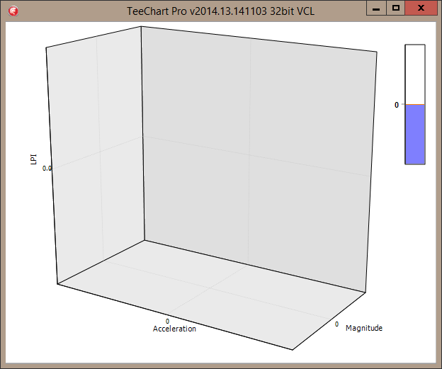

Re: Bug with TLegendPalette?
I open the project file I sent you, run it and move the mouse over the chart and the error appears, we use the same TChart version (mine is 32 bit under Windows 8.1 64 bit).
Regards
Regards
- Untitled.png (72.55 KiB) Viewed 54002 times

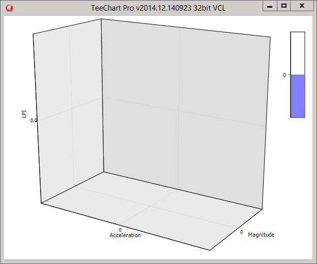

Same environment here: Windows 8.1 64 bit, RAD XE7 and TeeChart Pro v2014.12 binary.
Could this be caused due to some modification you may have done to the sources? Have you tried with the binary v2014.12?
I've added this to your project to check the TeeChart version being used:
And I can move the mouse around without any problem.
However, using SeriesList.FillSampleValues() I get an Exception after rotating the chart depending on the Rotation set, but this doesn't look as the error you are reporting:

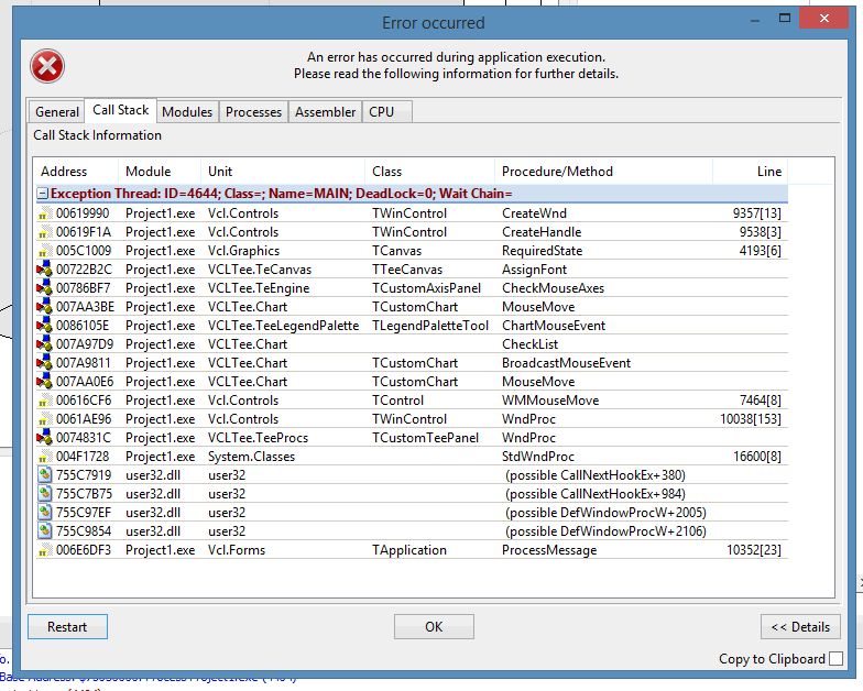

.. here is a screenshot when I enable EurekaLog, if it can be of any help
- Screenshot 2014-11-12 19.58.gif (39.5 KiB) Viewed 53888 times
Even if we can't reproduce the problem, looking at the Call Stack and debugging the application here I guess disabling Hover should skip the problem you are reproducing. Note TCustomAxisPanel.CheckMouseAxes funcion only does something when Hover is Visible:
I'm afraid we can't suggest much more without being able to reproduce the problem here.
I assume this is referencing the #1 in my last post.johnnix wrote:.. here is a screenshot when I enable EurekaLog, if it can be of any help
function TCustomAxisPanel.CheckMouseAxes(x,y:Integer):Boolean;
result:=False;
if Hover.Visible then
