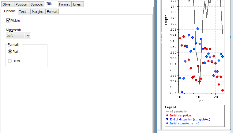

Attached you can see that switching the visibility of the legend title affects the border rectangle (latest TChar Pro 2014, XE6, Windows 8.1)
Legend border issue with 2014

Take a look at the project attached. I can't reproduce the problem with it, can you? Could you please modify it so we can reproduce the problem here?

Take a look now (I pasted my original plot). Please also notice that the left axis title does not appear to be drawn around the middle of the axis rather than starts from the middle.

At Chart.pas you'll find a nested function with the signature:
Just add this at the beginning of this function:
http://bugs.teechart.net/show_bug.cgi?id=809
I've reproduced it with v2014.11 but not with the actual sources, so I'd expect this to be fixed with the next maintenance release.johnnix wrote:Take a look now (I pasted my original plot).
Function CalcColumnsWidth(NumLegendValues:Integer):Integer;
ParentChart.Canvas.AssignFont(Font);
I've added it to the public tracker:johnnix wrote:Please also notice that the left axis title does not appear to be drawn around the middle of the axis rather than starts from the middle.

This is great, thank you so much!!!!
