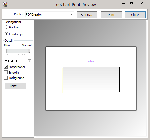

Can't reproduce this with TeeChart v2014.10 in Delphi 2010. I've created a new project, dropped a TChart, a TButton and a TChartPreviewer component to the form. Note by default the TChartPreviewer is called ChartPreviewer1 so my code looks like this:
  ChartPreviewer1.Chart:=Chart1;
  ChartPreviewer1.Execute;
And when I execute it, I see the chart in the preview as expected:
