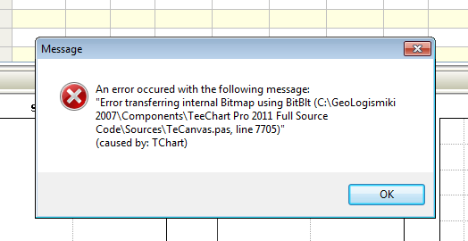

Please find attached an error message that appears under Windows 7, if I press CTRL+ALT+DEL and select lock screen, then when I login again this message appears. I am using TChart Pro 2012.07.120914 32bit. Any help would be mostly appreciated!!!
Error message after screen lock
- Screenshot 2014-02-04 22.10.png (13.19 KiB) Viewed 7866 times

Hi johnnix,
This might be related to ID333. I haven't been able to reproduce it now following your instructions. Can you please attach a simple example project we can run "as-is" to reproduce the problem here? You can also check if latest version available solves the problem at your end. Otherwise, you can disable assertions as I explained here.
