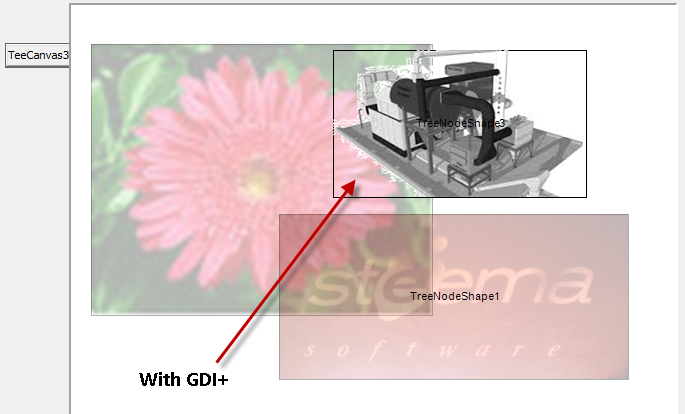

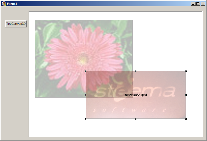

With GDI+ the background of picture I added, has a background transparent (It's a PNG)
If I clic on the button, it switch in GDI,after this, the picture has not a background transparent

Re: TTree is slow in design with Teechart2013
Post by Yeray » Wed Feb 05, 2014 4:03 pm
I could reproduce the problem so I've added it to the bug tracker:
http://bugs.teechart.net/show_bug.cgi?id=561
Feel free to subscribe to the ticket status by adding your mail to the CC list.
