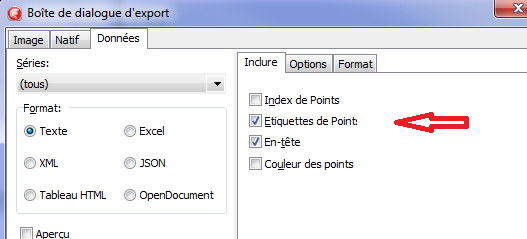

I've note 2 small glitchs in the french dialogs:
1) Checkbox size too small for translation
TeechartExportGlitch #2.png (33.07 KiB) Viewed 16229 times

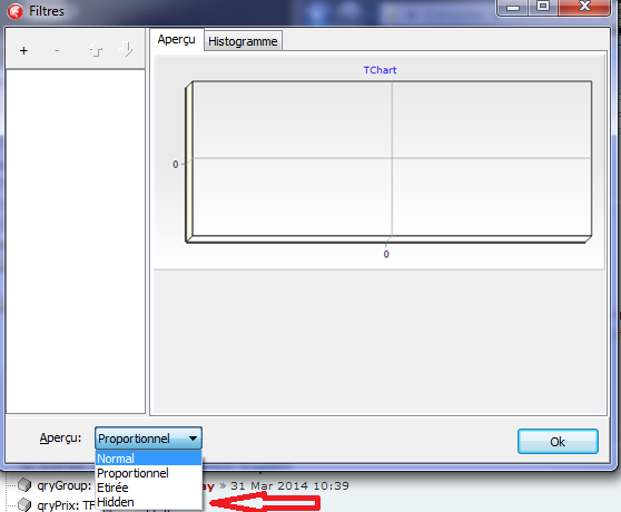

2) list box item not translated (in the filters dialog)
TeechartExportGlitch #1.png (46.6 KiB) Viewed 16233 times

zyma wrote:1) Checkbox size too small for translation
Corrected for the next maintenance release. Thanks for reporting it.
zyma wrote:2) list box item not translated (in the filters dialog)
You can declare set the HIDDEN variable as follows:
uses EditChar, TeeTranslate, TeeFrench, TeeConst;
  EditChart(Self, Chart1);
  TeeSetFrench;
  TeeFrenchLanguage.Text:=TeeFrenchLanguage.Text+'HIDDEN=Caché'+NewLine;

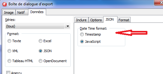

Found 2 other small glitches (one is size, the other is captions not translated.)
I've started comparing the units... what is the best way to process, I'll translate and fix my code to fit my immediate needs (I really need to release the software) , but what's next... can we except a complete fix soon... ???
TeechartExportGlitch #4.png (23.67 KiB) Viewed 16203 times
TeechartExportGlitch #3.png (24.49 KiB) Viewed 16201 times

Re: French Export
Post by Yeray » Wed Apr 02, 2014 8:09 am
I've set this label wider to fit it with the next maintenance release.
Add this to TeeFrench.pas:
'HIDDEN=Caché'+NewLine+
