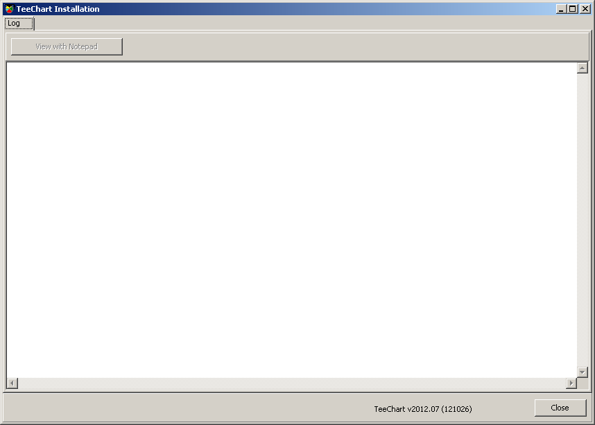

I've just tested pre-release for XE3, at the end of installation I got message: "The installation was aborted by the user. Run TeeInstall or TeeRecompile to install the package at a later time . Compilation aborted.":
Error message
The log file is empty:
Empty log file

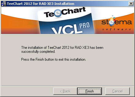

After show message:
The installation successfully completed
