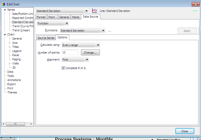

I use a standard deviation function with settings as shown in screenshot.
This doesn't work in TeeChart VCL 2012.05, it works in TeeChart VCL 2011.04.
Using XE2.

Right. I've reproduced it so I've added it to the defect list to be revised (TV52016179).
It seems is was introduced when trying to fix this.
Thanks for reporting it.
