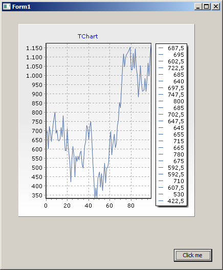

Re: AntiAlias issue
Post by Yeray » Tue Apr 03, 2012 8:47 am
Hi Johnnix,
That's what I get with it. I'm not sure to see any "missing segment":
