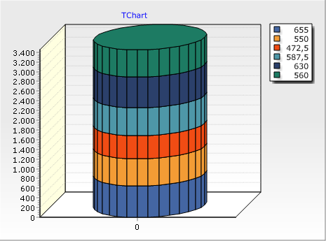

I'm afraid the smoothed curves is one of the GDI limitations.
Here you have the results I get with GDI, GDI+ and GDI&AntiAliasTool.
  Chart1.Chart3DPercent:=100;
  with Chart1.AddSeries(TBarSeries) as TBarSeries do
    FillSampleValues();
    BarStyle:=bsCilinder;
    MultiBar:=mbSelfStack;
    Marks.Visible:=false;
    ColorEachPoint:=true;
    Dark3D:=false;
