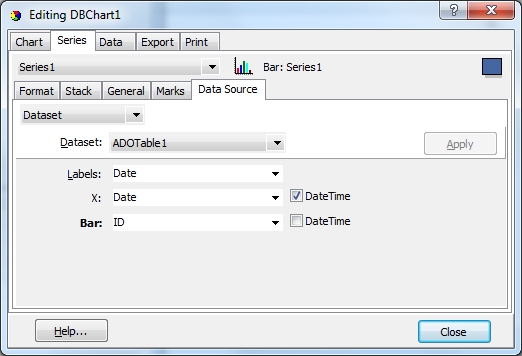

I have a series grouped by month.
I want it to sorted correctly.
How?

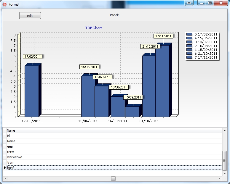

To achieve what you request you can change your datasource to use a dataset like this:
Which produces this chart:
Is that what you were looking for?

No
It should be grouped my month and sorted by month (dec2010,jan2011,feb2011....)
It can be more than one row in each month

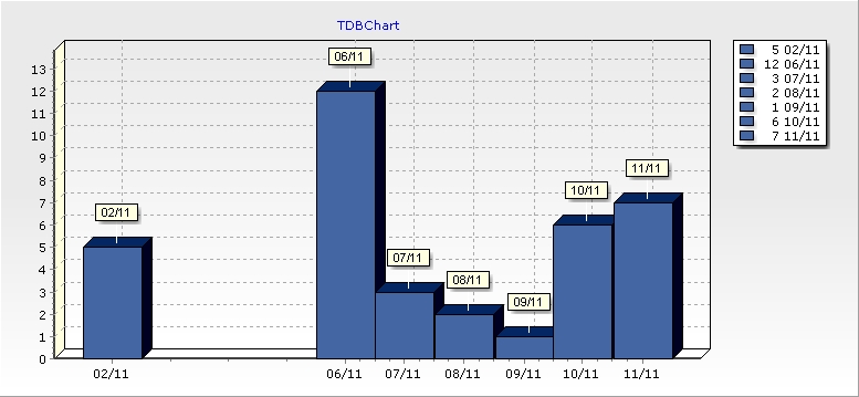

Better, but the x location of the bars is not correct.
It should not care about the date, just the month.

With the code as it stands the bars are set at the location of the date of the last value in that month. We assume that you would prefer the bars to centre on that month. Is that correct?

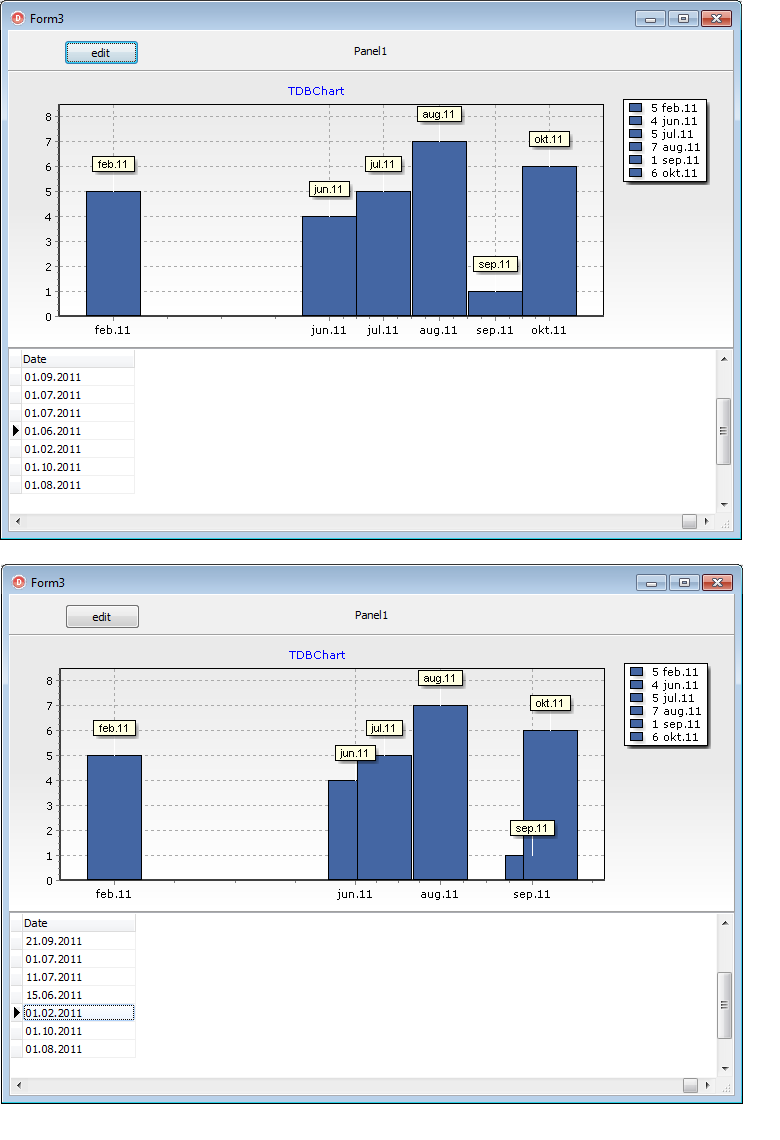

Think it is tha same for me if it is first, midle or last day in the month, the problem is that it doesn't work like this for me. It uses the actual date. Take a look at the second image.
