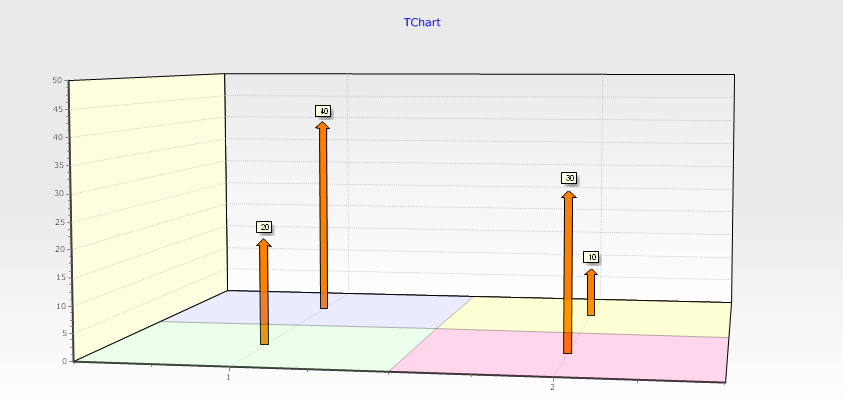

Is it possible to show a map series (normally shown on the x-y plane) on the x-z plane? I want to be able to show a map in 3d and then place another series on top of it using bars to show a numerical value for that shape. Like a bar showing the population densitity of an area, the average power usage, etc. I have created a screen shot using a 3d bar series for the 'map' (in this case all squares) and a 3d bar series showing the values for that area.
Kind regards,
Michael.
3d chart of two 3d bar series

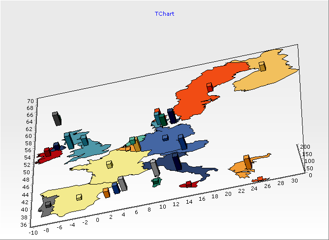

I finally got something that looks quite well:
uses TeCanvas;
var Map1: TWorldSeries;
    Sizes: array of Double;
var i: Integer;
  Chart1.Legend.Visible:=false;
  Chart1.Aspect.Orthogonal:=false;
  Chart1.Aspect.Elevation:=50;
  Chart1.Axes.Depth.Visible:=true;
  Chart1.Axes.Bottom.ZPosition:=100;
  Chart1.Axes.Left.ZPosition:=100;
  Chart1.Axes.Bottom.Grid.Visible:=false;
  Chart1.Axes.Left.Grid.Visible:=false;
  Chart1.Axes.Depth.Grid.Visible:=false;
  Chart1.Walls.Bottom.Visible:=false;
  Chart1.Walls.Left.Visible:=false;
  ScrollBar1.Max:=360;
  ScrollBar1.Position:=Chart1.Aspect.Elevation;
  Chart1.Axes.Depth.SetMinMax(-200,0);
  Map1:=Chart1.AddSeries(TWorldSeries) as TWorldSeries;
  Map1.Map:=wmEurope15;
  Map1.ColorEachPoint:=true;
  SetLength(Sizes, Map1.Count);
  for i:=0 to High(Sizes) do
    Sizes[i]:=Random()*100;
var i: Integer;
    XVal, YVal: Integer;
  for i:=0 to Map1.Count-1 do
    XVal:=Map1.Shapes[i].Bounds.Left + ((Map1.Shapes[i].Bounds.Right-Map1.Shapes[i].Bounds.Left) div 2);
    YVal:=Map1.Shapes[i].Bounds.Top + ((Map1.Shapes[i].Bounds.Bottom-Map1.Shapes[i].Bounds.Top) div 2);
    Chart1.Canvas.Brush.Color:=Map1.ValueColor[i];
    Chart1.Canvas.Cube(XVal-5, XVal+5, YVal-5, YVal+5, Chart1.Axes.Depth.IEndPos-Chart1.Axes.Depth.CalcSizeValue(Sizes[i]), Chart1.Axes.Depth.IEndPos);
procedure TForm1.Chart1GetAxisLabel(Sender: TChartAxis; Series: TChartSeries;
  ValueIndex: Integer; var LabelText: string);
  if Sender = Chart1.Axes.Depth then
    LabelText:=FloatToStr(Abs(StrToFloat(LabelText)));

The solution you have provided will help me along the way. I am going to have to add features a normal bar series has but I think this is usable. I'll let you know once I have added your solution to my code. Thanks for the code example and the effort. It is quite an out of the box solution.
