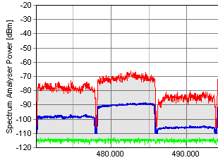

A Chart tool calculates a band between tow series.
On "TeeGDIPlus1.Active := false;" this works pretty good but on "TeeGDIPlus1.Active := true" the band has been switched off or to transparent color.
How can I fix this?
This pictures show the difference if TeeGDIPlus1.Active is set.

Hello Yeray,
Thank you for your replay!
For me it looks like an inverted tape color.
I've changed the chart.tool.transparence to 50%.
On GDI+=off I can see the expected grey tape.
On GDI+=ON now I see a transparent white tape.
How can I change the tool.tape color on running time?
This might solve my problem?

Hello Yeray,
The tip does not work here but I found a solution.
I've set the the tool gradient twice to grey.
This has been "solved" the problem.
