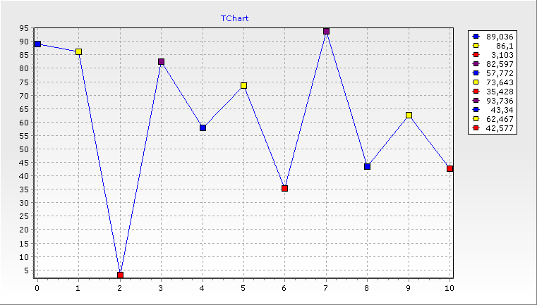

I've simplified your example a little bit to make it run here:
uses Series;
var Series1: TLineSeries;
    j: Integer;
  Chart1.View3D:=false;
  Series1:=Chart1.AddSeries(TLineSeries) as TLineSeries;
  Series1.Pointer.Visible:=true;
  Series1.ColorEachLine:=false;
  Series1.SeriesColor:=clBlue;
  for j:=0 to 10 do
    case (j mod 4) of
     0: Chart1[0].AddXY(j,random*100,'',clblue);
     1: Chart1[0].AddXY(j,random*100,'',clYellow);
     2: Chart1[0].AddXY(j,random*100,'',clRed);
     3: Chart1[0].AddXY(j,random*100,'',clPurple);
The code above give this result for me here with the latest version (v2011.03):

thanks for your quick help: I did not use the latest version of TeeChart when posting my problem but now I'm doing so, and actually, everything works fine! :D
