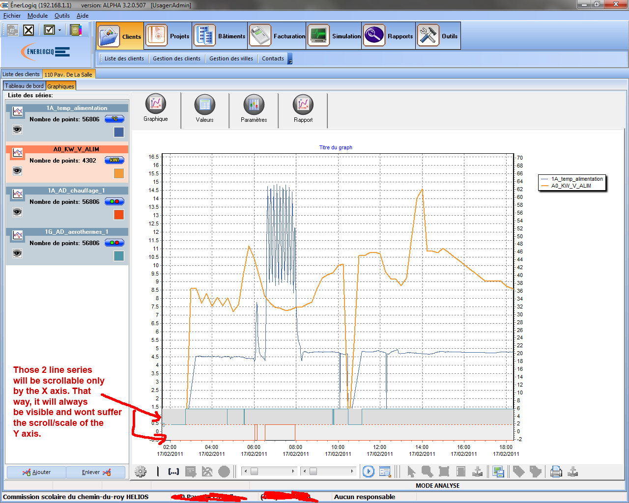

Hi again
I though you may need more information. So there is a screeny of what i have done so far.
ScreenShot about the line series without Y axis
I did paint the background to be easier to see the 2 lineSeries.
As i told you before, im using the TChart.Series for a lots of stuff (Live Reports, Saving the graphics into my DB, showing a table of values, etc..)

Oh well, im sorry to have bother you again. Sometimes, my brain just want to remake the world in its own way! :? Anyway, i just figure out that the only thing i had to do is to create a new kind of series from TSeriesLine and override the DrawValue fonction and then, add my code in it. So simple. I must need vacation lol.
Thanks to you to have make it simple as that to make custom series ect... I just finished it and it works like a charm!
