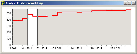

is it possible to realize something like an "open curtain" with the cursortool (or anything else).
With two cursortools I select the area of interest the remaining areas of the chart are grayed (but transparent).
Please, see the picture to get my intention.
Moreover, it would be great to be able to move the area of interest with one mousemove.
Josef

Hi Josef,
You could use a TColorBandTool and change its StartValue and EndValue at OnMouseMove event.
Here it is a simple example:
uses Series, TeeTools;
var ColorBand1: TColorBandTool;
    rectWidth: Integer; //pixels
procedure TForm1.Chart1MouseMove(Sender: TObject; Shift: TShiftState; X, Y: Integer);
  with ColorBand1 do
    StartValue:=Chart1.Axes.Bottom.CalcPosPoint(Round(X-rectWidth/2));
    EndValue:=Chart1.Axes.Bottom.CalcPosPoint(Round(X+rectWidth/2));
  Chart1.View3D:=false;
  Chart1.Legend.Visible:=false;
  rectWidth:=50;
  with Chart1.AddSeries(TLineSeries) do FillSampleValues();
  ColorBand1:=Chart1.Tools.Add(TColorBandTool) as TColorBandTool;
  with ColorBand1 do
    Axis:=Chart1.Axes.Bottom;
