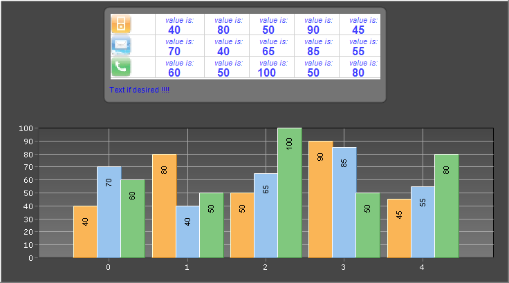

Exporting the demo from the features demo at What's New ?\Welcome !\New Chart Tools\Custom Legend it seems to look fine:
So I think it could be something in your code.
Could you please arrange a simple example project we can run a-is to reproduce the problem here? Thanks in advance.
