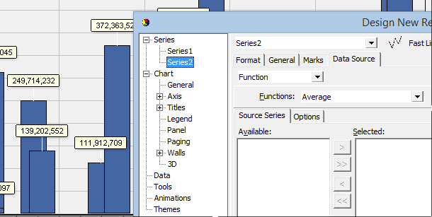

I have to resurrect this problem as it is now occuring for me in XE4. When I was last posting this I was using XE2. Since then I was able to get it to run using XE4 and your XE4 Beta update. However, with your latest update for XE4, I am not able to get this to work.
To refresh the problem. I have a C++ application that is MDI based and creates TCharts on forms that are located in DLLs. In the DLL, the standard design form (SDF) contains a basic TDBChart and TChartEditor.
When I wish to design a report, I dynamically create a TDBChart internally and load it with all the report information. This chart is created with owner being the currently active MDI child. At this point, the chart is ready to be displayed. I then create the standard design form (SDF) passing in the internally created chart. In the constructor of standard design form (SDF), the processing substitutes the static TDBChart (on the SDF) with the passed in one, and then the form is made visible. The following is the code that is used to substitute charts:
The PanelDisplay is the Parent of the old DBChart, and is a child of the Active MDI Child. Also, the ChartEditor is the static TChartEditor that is on the standard design form (SDF).
At this point my standard design form (SDF) is showing. In order for me to change the chart, I double click on the chart and it open the runtime ChartEditor. On the sample that I have included, I have two series on the chart, a Bar Series (Series1) and an Average Series (Series2). At this point I should see Series1 in the Available list, but I do not. (In the attached image, you can see part of Series1 in the display).
Up until this recent update, this all worked. I have tried every conceivable thing that I can think of and I cannot make this work. Have you got any ideas of what I am doing wrong?
delete DBChart;
DBChart = report->db_chart;
DBChart->Parent = PanelDisplay;
DBChart->Visible = true;
ChartEditor->Chart = DBChart;
- Empty Available List.png (26.84 KiB) Viewed 31850 times
