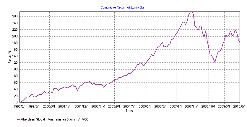

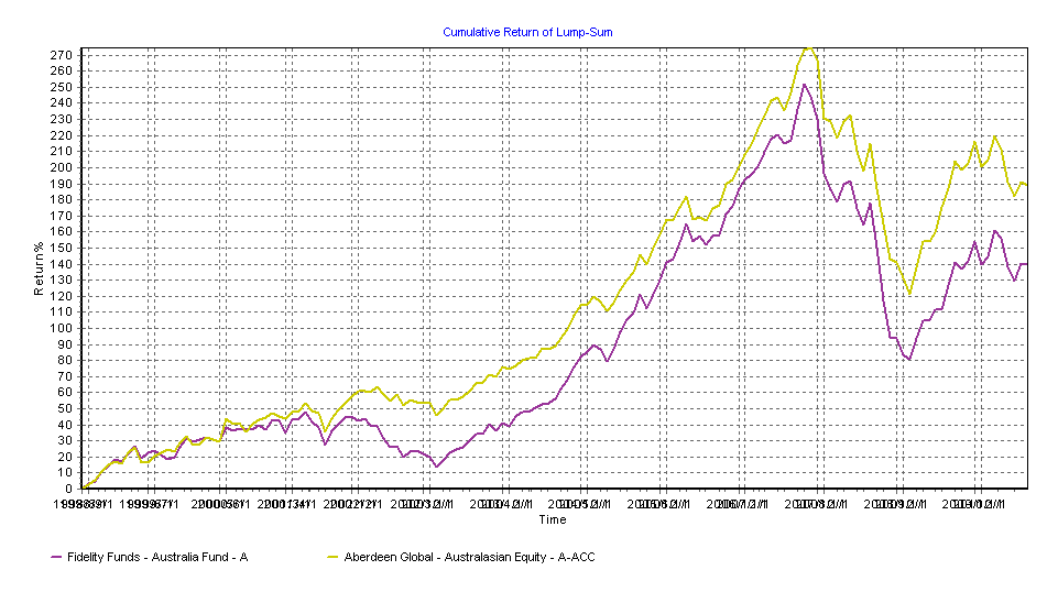

Teechart 7.gif:original chart
Teechart v2010.01 VCL non-stable prelease.gif: after install Teechart v2010.01 Prelease.
Daniel
After install Teechart v2010.01 Prelease, the bottom axis of teechar become very strange.
the bottom axis's label is overloped.
as attached file

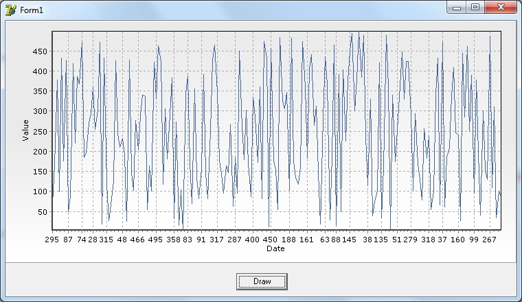

Hi Daniel,
Here's a screen-shot of what I get using our current 2010 sources:
Is this what you get? If not, you may expect the issue to be fixed for next maintenance release.

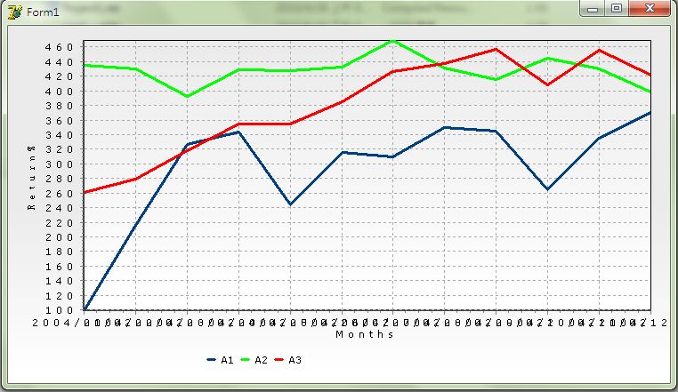

Hi:
Teechart VCL v2001.01 is really unstable.
Lables of bottom axis overlaps.
Image and sample program is attached.
When will stable maintance release launch?
Daniel
Daniel

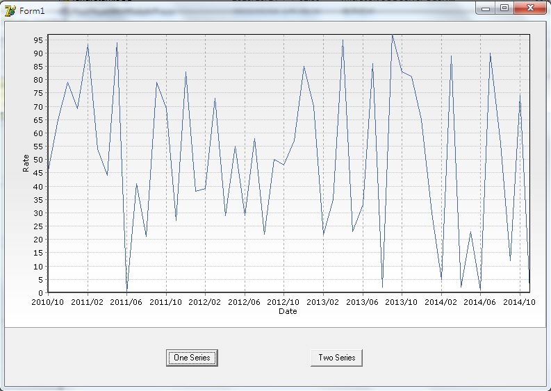

If you click one series the chart works fine.

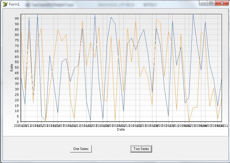

if you click two series you can see the label of bottom axis overlape.
Daniel

Re: Strange Bottom Axis
Hi Daniel,
It looks to be the same. I've seen that it works in v2010.00 and overlaps in v2010.01. I've incremented the ticket priority (TV52015179).

Hi Daniel,
After investigating the issue in Draw.zip further we came to the conclusion that this is not a bug. We found that in your project you had set bottom axis LabelsSeparation property to zero, thus no label anti-overlap calculation is performed. Setting LabelsSeparation to default value (10%) works fine:
Chart3.Axes.Bottom.LabelsSeparation:=10;
