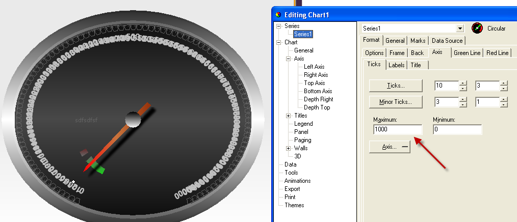

Actually we think about to buy the V2010 update. I tried the demo and watched the new gauges. They look really nice and have a lot of options.
But i miss one feature. If you set the Maximum to 1000 and the minimum to 0 you will get the result like in the picture.
How can I reduce the number of Ticks and minor Ticks?
Greetz Dominik

Hi Dominik,
Setting axis increment should solve that, for example:
  Series1.Axis.Increment:=50;
This should be in the editor too so I have added it to the wish-list (TV52014853) to be considered for inclusion in future releases.
