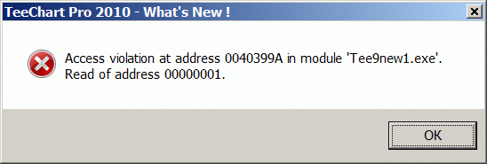

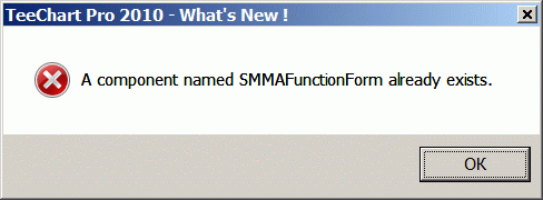

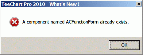

Re: TeeChart VCL v2010 Release!
Yes, these errors disappeared.Yeray wrote:Hi,
We've recompiled the demos and we think that these problems are solved. Could you please try them again?
However, the application is still unstable and sometimes show unreproducible errors and AVs:
And after some of them the program remains in memory after closing.
- AC(Acceleration/Deceleration) form
- AC.gif (12.8 KiB) Viewed 36793 times
- AR(Average True Rate) form
- ATR.gif (14.99 KiB) Viewed 36799 times
- Smoothed Moving Average form
- SmoothedMovingAvg.gif (13.34 KiB) Viewed 36791 times
and some more:
PS. Usual address of support forum http:\\support.steema.com doesn't work: the server tells "Internal Server Error".Regards, Alexander
