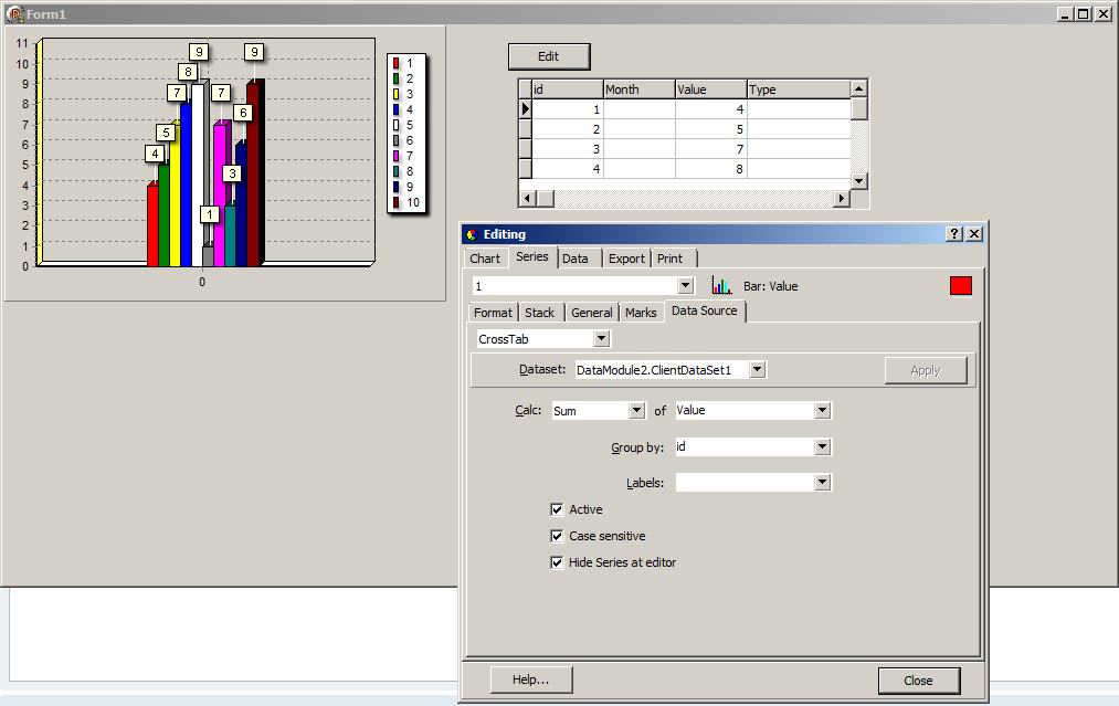

Post by Yeray » Wed Mar 24, 2010 10:09 am
Hi Jørgen,
Could you please tell us the exact steps we should follow with your testing application to reproduce the problem here?
Here is what I'm getting:

Re: IsValidDataSource is not used in TDBChartCrossTabEditor
Post by jls » Wed Mar 24, 2010 10:29 am
You have done it correct
The problem is that all datasets are available for crosstab source.
ClientDataset2 should not be on the list.
If you try to use a dataset as source you can see that only ClientDataset1 is available.
Jørgen
