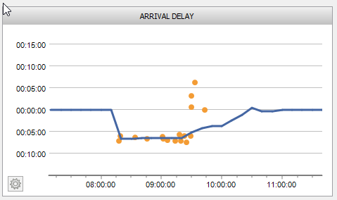

We frequently display time values (in the sense of a period of time, or a duration) in a chart, such as a delay. See the image below for an example.
Delay Example.png (9.64 KiB) Viewed 49210 times
As you see, the delay values can obviously also get negative. Unfortunately, the left axis displays the negative times in the same way as positive ones and we have not found any way to change or customise this behaviour.
I was hoping to be able to solve this using the OnDrawAxisLabel callback, but without the tick value I have no clue on how to achieve that.
