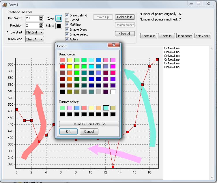

I want to add custom colors to the color dialog , which appears when TColorButton is clicked. Is there any possibility to add a 'custom color string' to the TeeChart application?

>Do you have a list of colors you want to be shown in the below part of the series' color picker window?
-Yes. Please see image attached. The code above was used with TC v7.12

- TButtonColor dialog with pre-defined custom colors
- PenDraw_05.jpg (89.87 KiB) Viewed 18084 times

I have no problem adding colors to the standard TColorDialog. The one you see on the picture is an internal TColorDialog from TButtonColor, which is a TeeChart component (lime color button on top of the form). The problem is that this color dialog is not public neither published, so there is no regular access to it. The fix I posted above gives access to TCustomColorString inside TeCanvas unit, but this is not nice way to do it. I hope that Steema can change this internal TColorDialog to published, so it could be edited at design time.
