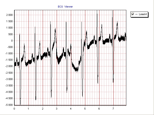

I have a plot of a time series like this :

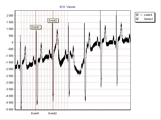

Why the numerical values on the X axis labels are replaced with the labels of the second series ?
Can I add the pointseries with labels (to show them inside markers) without displying the labels on the X axis ?

Hi Yazou,
I think that you are looking for this:
Chart1.Axes.Bottom.LabelStyle:=talValue;
