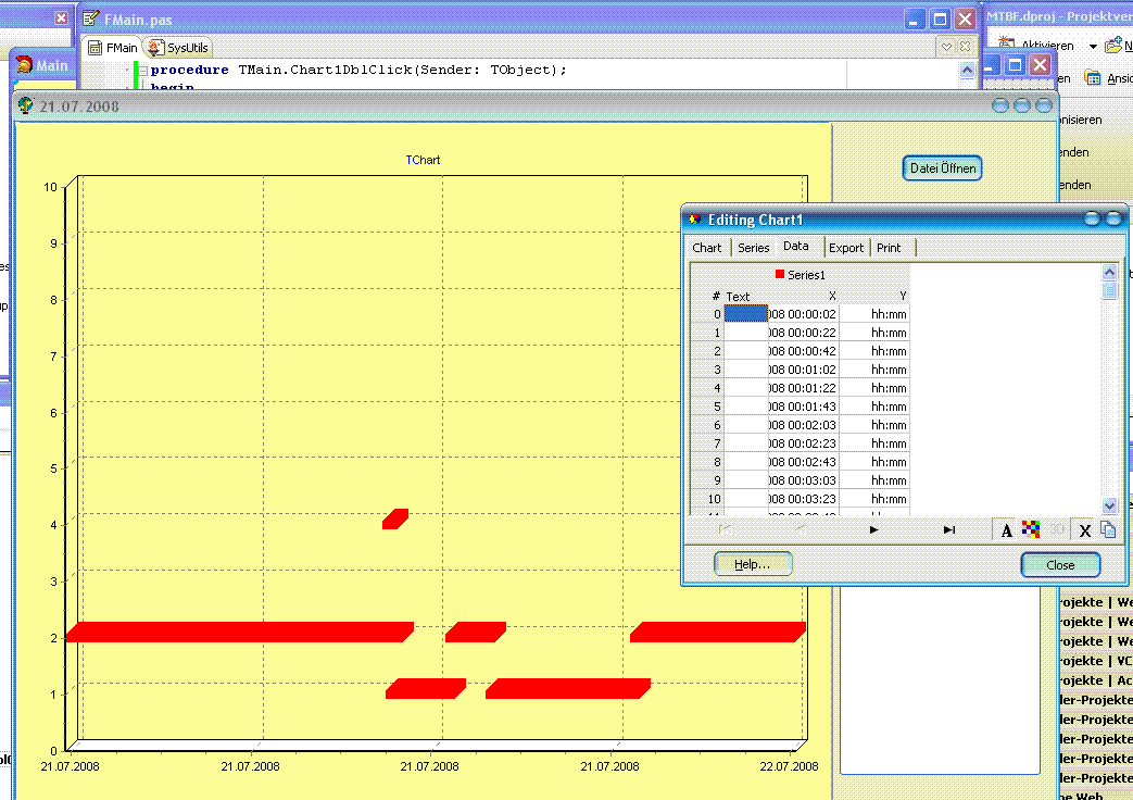

If I add DateTime Values to the bottom axis an open a Charteditor at runtime, the x values are shown correctly but the y values show the DatTime FormatString ('hh:mm') instead of the correct data. y data points are simple integer values.
See attachment.

I see in your project that you've changed you series' ValueFormat from #,##0.### to hh:mm at design time. Note that this is for the YValues, so here it is the explanation of your result.

Yes, you're right. I thought that this was the correct position to set. So where can I set the format string for the DateTime X Axis?

To show hours:minutes in the bottom axis you should do as follows:
  Series1.XValues.DateTime := true;
  Chart1.Axes.Bottom.DateTimeFormat := 'hh:mm';
