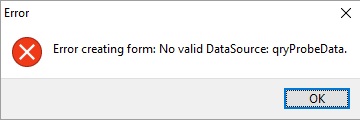

But when i tried to open the form that uses the tqrchart then it errors. See attached image.
This also happens when i made a new app with just the chart on it.
If i could work out which module is the problem then i could make sure it has it in the path.
I have checked and all the applicable paths are available.
Are you able to do a compile at your end and sent through the files like you did some time ago.
We are using Delphi Berlin 10.1, our development project is 32bit atm still. And the Quick Report 6.
We upgraded our Quick reports to Quick Reports 6 using the "QR6DXE10_1_Berlin_W64_installer.exe".
Because of this issue i decided to do a full reinstall. I uninstalled all software / components. and manually checked that registry and files to make sure it was completely clean.
I installed delphi, quick reports and then teechart.
Then I went through the install procedure for the TQChart.
When i put the files in the locations then tried to add package from the bin it said "Specified Module not found". So i put the bpl and dcp in the Public users bpl,dcp output folder.
At this point i could install package.
- Error.jpg (12.36 KiB) Viewed 51544 times

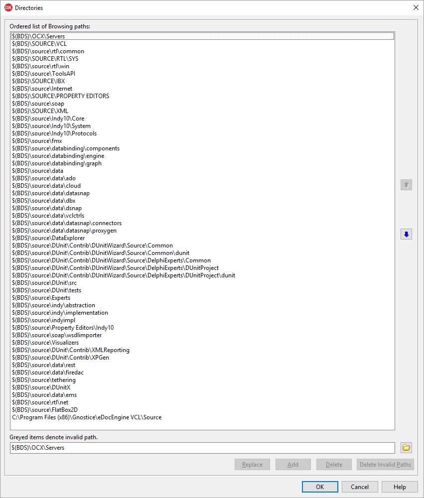

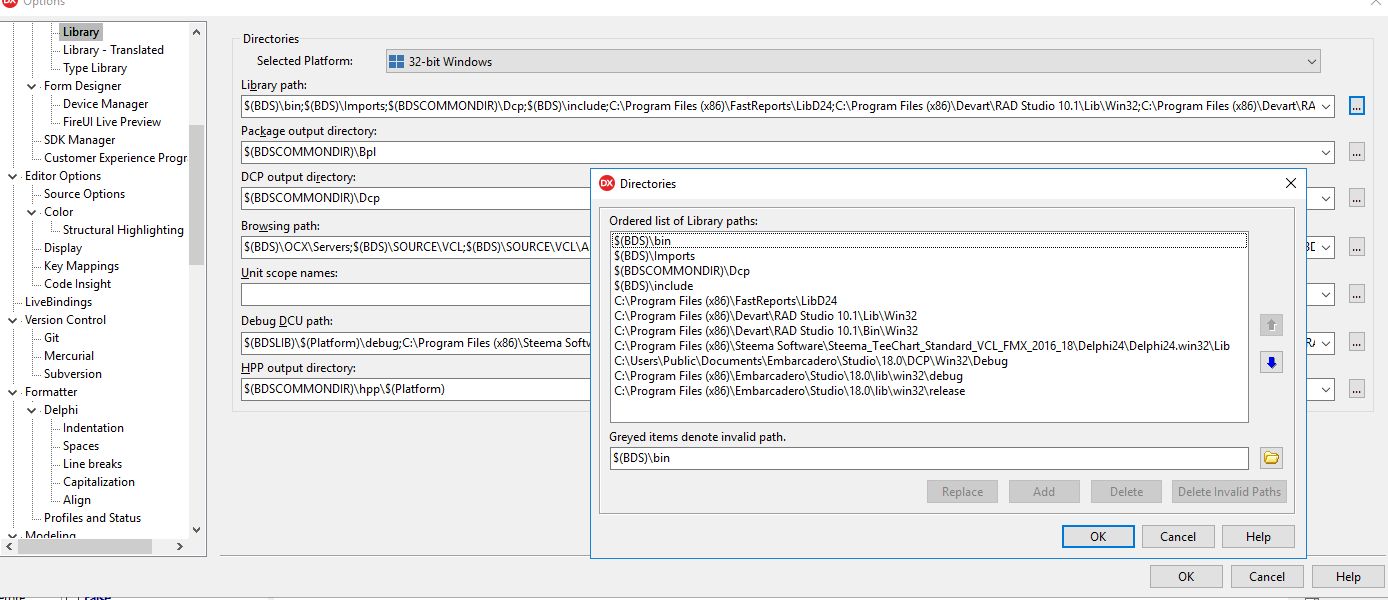

Sorry to say that it was no joy there, same error as previous. I have followed the instruction and then tried various other ways eg... like adding files to the public dcp/bpl folders. but every time it says that a specified module cannot be found. I do wish it would tell me what the module is that is missing though. I have looked at the required units that the compiled versions asked for and they seem to be all there and a single path/file to them too.
I have attached a couple of screen shots of the options library section, is there anything that looks like is missing.
Cheers
Carl
Cheers
Carl
- Library Paths.jpg (131.75 KiB) Viewed 51430 times
- Browsing Paths.jpg (205.84 KiB) Viewed 51426 times

Sorry still have same issue as before, it will install ok but then when try to use compoents it cant find datasource.

Re: QRTeeChart - Missing Datasource. Quick Report 5 and 2016.18
Yes i have that at the moment as that is the only way i can get it to install.
The compile/ build goes fine.
I tried a new form and put a quick report frame on it plus a sub detail band and a chart. As you can see it has added the qrdbchart plus the qrchart when i put a chart on the page. But when add the line series in it's datasource it is missing the datasource option from the drop down. the link between the 2 charts does not seem to be there.
The error screen shot is from my main app when i try to load it in to design mode.
I also unistalled every thing again plus 3rtd Party components, purged the registry of any links and so it was a complete fresh install with the defaults in place.
Hope this gives more info. I realise this just works for every body but not for me.
- Librarypaths.png (52.28 KiB) Viewed 51370 times
- Full Error Question Screen Shot.png (87.9 KiB) Viewed 51377 times

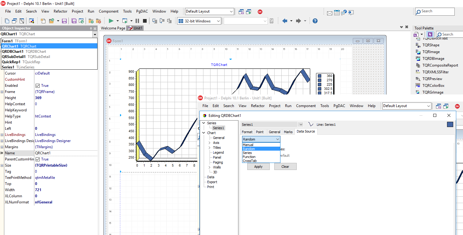

I've tried the test project from this post with the packages here and it seems to work without problems for me here.
If you can use a Dataset in your TDBChart and it works fine, but you still find problems with the dataset in the TQRDBChart, you may want to try a different approach. You can put a TQRImage in your TQuickRep and draw the chart using the Canvas in the TQRImage. Ie:
Have been flat out upgrading other apps so havent haven't tried that approach yet. Bu have no choice but to do so as my last ditch attempt failed.
I recently installed on to a fresh Win10 pc that has never had any developing programs on it, Berlin 10 with update 1.
All the 3rd party programs pgDac, Quick Report 6 Pro, Gnostice, including teechart installed correctly with no problems and all work as they should.
So now i try the TQRChart install. The quick report was changed to QRWRunDXE10_1_W64 that was all that was needed. Both the Tee and the DCL compiled correctly with no errors.
I copied the files to the appropriate locations, when i tried to add the package that failed. with the usual specific module not found. Library paths for all units/dcp/bpl where availbale.
I removed all the files from the relevant locations where i had put them and added a file path in the library to the compiled files location.
I was able then to add the package from that location. No Errors at that point.
I created a new app and on there i put a quick report and subdetail band and added a chart. no problesm so far until i select a datasource from the series section and find that the dataset, single record was missing.
The fact this is a fresh pc with no hang ups from old software etc.. makes me wonder.
Delphi was installed as is, i did not change any options it was all stock standard.
Hello Carl,
I tried it again a couple of times and I ended reproducing "the specified module could not be found" problem.
Your solution of using $(BDSCOMMONDIR)\Bpl didn't work for me.
I also tried to completely uninstall and reinstall the IDE. This didn't work either.
Then I thought there must be something that isn't correctly uninstalled and I launched the IDE with an option to reset the registry to the defaults:
http://docwiki.embarcadero.com/RADStudi ... nd_Options
Then I could load the DclTee9QR6D24.bpl without problems from $(BDS)\bin again with these packages:
And I can see the "single record" option without problems.
bds.exe -cleanregistryide
