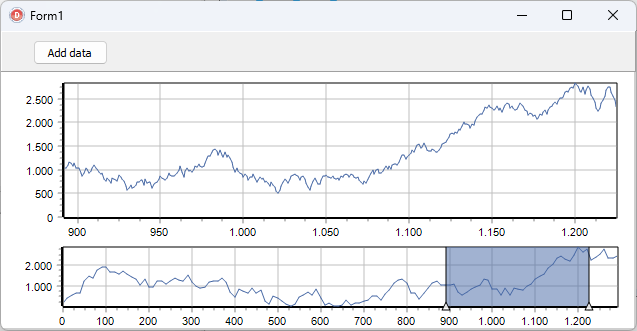

Here a simple example:
uses Chart, Series, TeeScrollPagerTool;
var Chart1: TChart;
    scrollPagerTool: TScrollPagerTool;
    mainSeries: TLineSeries;
    scrollSeries: TLineSeries;
var
  i: Integer;
  Chart1:=TChart.Create(Self);
  with Chart1 do
    Parent:=Self;
    Align:=alClient;
    Color:=clWhite;
    Gradient.Visible:=False;
    Walls.Back.Color:=clWhite;
    Legend.Hide;
    View3D:=False;
    mainSeries:=TLineSeries(AddSeries(TLineSeries));
    mainSeries.FillSampleValues(1000);
    scrollSeries:=TLineSeries.Create(Self);
    scrollSeries.Color:=mainSeries.Color;
    for i:=0 to mainSeries.Count-1 do
      if i mod 10 = 0 then
         scrollSeries.AddXY(mainSeries.XValue[i], mainSeries.YValue[i]);
    scrollPagerTool:=TScrollPagerTool(Tools.Add(TScrollPagerTool));
    scrollPagerTool.AddSeries(scrollSeries);
    scrollPagerTool.SubChartTChart.SeriesList.Delete(0);
procedure TForm1.BAddDataClick(Sender: TObject);
var i: Integer;
    d: Double;
  d:=mainSeries.YValues.Range / 10;
  for i:=0 to 99 do
    mainSeries.Add(mainSeries.YValue[mainSeries.Count-1]+(random*d)-d/2);
    if (mainSeries.Count-1) mod 10 = 0 then
       scrollSeries.AddXY(mainSeries.XValue[mainSeries.Count-1], mainSeries.YValue[mainSeries.Count-1]);

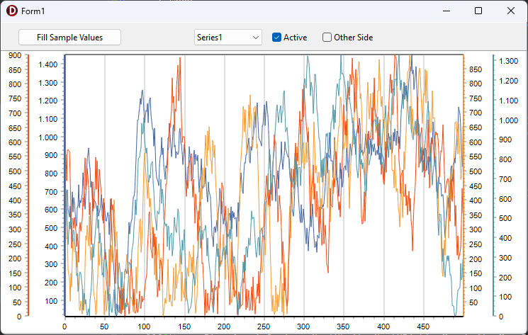

Two pictures:
One axis: https://www.directupload.eu/file/d/8826 ... oz_jpg.htm
Two Axes: https://www.directupload.eu/file/d/8826 ... 6r_jpg.htm
Rectangles:
A) One rectangle with the curves/signals --> "signal area"
B) One rectangle with axes/scales, width of single axis rectangle identical to others --> "axes rectangle"
C) One rectangle with bottom axis/scale
D) One big rectangle that encloses the entire picture
E) 'Rest' rectangle in the bottom-left corner
Width of one rectangle (B): Font size (height! 90° rotation), length of major tick, some margins ( |<Margin>Title/Fontheight <Margin>Major Tick| )
Width of one axis' rectangle multiplied with number of axes = width of 'axis rectangle'
Height of bottom axis (C): Font size (height), length of major tick, margins analog to the ones of the vertical axes
Left of rectangle "signal area" and "bottom axis" = D.left + B.width
Bottom of rectangle "signal area" and "axes rectangle" = D.bottom - C.height
width of signal area = width of bottom axis
height of signal area = height of left axes
If the number of signals (axes) changes, the width of (B) changes, so that signal area has more or less space (width).
The grid is always painted in the signal area's rectangle only.
All font sizes, margins and rectangle values (left/top/right/bottom, width/height) are pixels MULDIV'd with screen DPI.

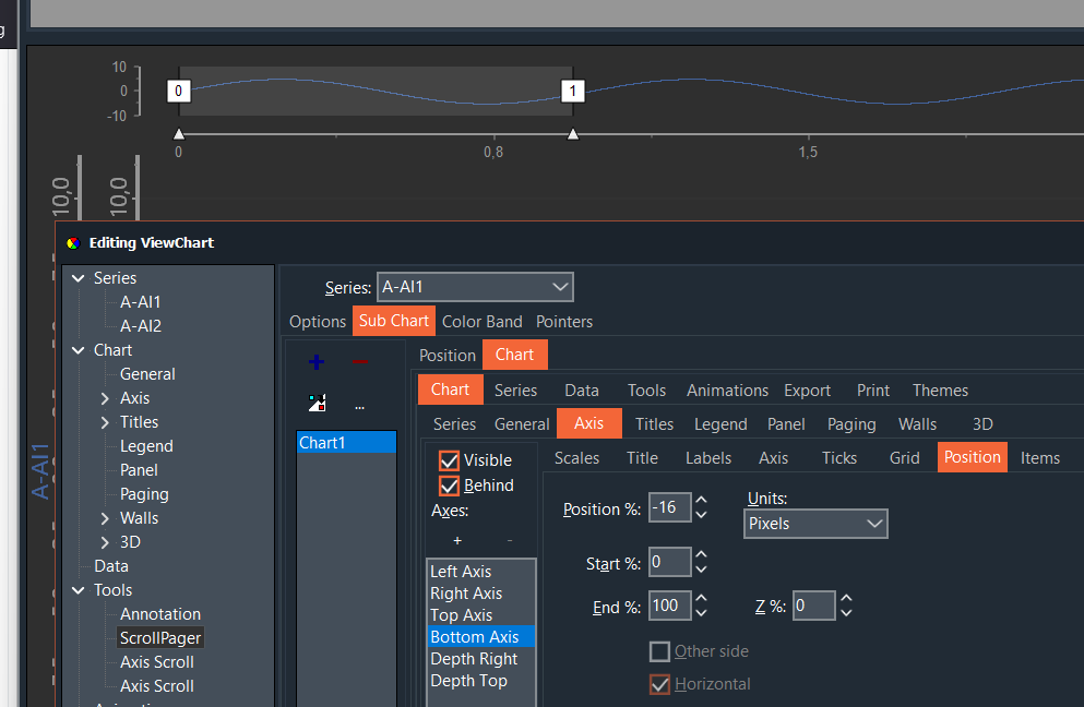

The attached image shows, that the scrollpager's chart is horizontally not aligned with main chart. (Both bottom axes should start at same x position and have the identical length/end position.)
After calling PlaceAxes and adding series to the scrollpager:
ScrollPagerTool.SubChartTChart.MarginUnits := muPixels;
ScrollPagerTool.SubChartTChart.MarginLeft := ViewChart.MarginLeft;
ScrollPagerTool.SubChartTChart.MarginRight := ViewChart.MarginRight;
Ja, that does not do the trick... what do I need to do, to have the scrollpager's bottom axis start and end position at corresponding positions, please?

Any idea about positioning the chart and axes of the scrollpager to fit the requirements in my previous post?
MXHW wrote:
Mon Feb 17, 2025 1:17 pm

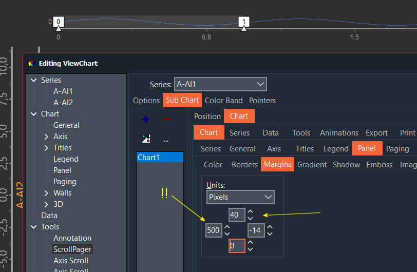

I tried modifying the subcharts panel: margin top and bottom can be modified, but left and right ignore the values set.
The top of the chart 'loses' height with increasing top-margin. Ok, works.
But the left (and) right margin setting ignores any value.
I tried modifying the axis positions.
The left axis can be moved to the left, but the bottom axis vertical position is only movable to the right, because setting "Start %" cannot be negative!
How to align the scrollpager's axes with the ones from the main chart, please?

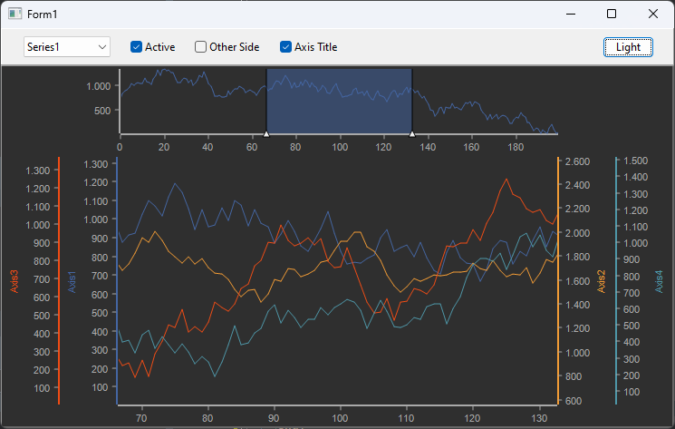

Re: Distance between axis tick and label text, and more questions
Post by Yeray » Tue Feb 25, 2025 10:03 am
You could set your TScrollPagerTool.Align to saCustom and then set the its positions manually at the same PlaceAxes method:
  with ScrollPagerTool.SubChartTool.Charts[0] do
    Top:=0;
    Left:=0;
    Width:=Chart1.Width;
    Height:=Round(Chart1.Height / ScrollPagerTool.DivisionRatio);
    Chart.MarginUnits:=Chart1.MarginUnits;
    Chart.MarginLeft:=MargLeft-Chart.Axes.Left.MaxLabelsWidth-Chart.Axes.Left.TickLength;
    Chart.MarginRight:=Chart1.MarginRight;
Here the full example:

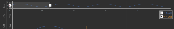

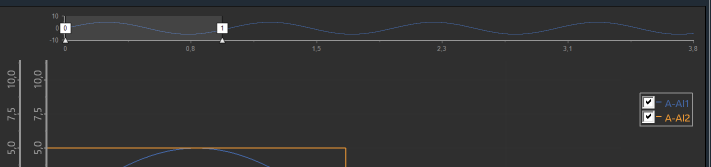

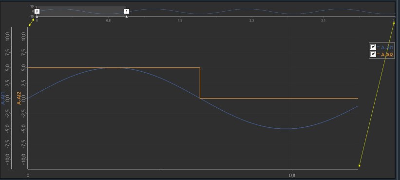

Please examine the position of the Scrollpager: The only difference is, saBefore was changed to saCustom for the Scrollpager's align property:
saBefore
saCustom
In your example the TChart leaves enough space at the top even with saCustom for the Align property, so that the scrollpager's chart fits into the 'gap'.
In my project the TChart does not reserve space for the Scrollpager if the Align property is set to saCustom.
The DivisionRatio property set to 8.0 for saBefore and saCustom scenario.
Post by Yeray » Tue Mar 11, 2025 10:18 am
MXHW wrote:
Mon Mar 03, 2025 10:50 am
Indeed I set the DivisionRatio to 4 and the MarginTop to 100 manually.
Instead, you can set the MarginTop at the PlaceAxes method after calculating the Height of the subchart according to the DivisionRatio.
    Chart1.MarginTop:=Height;  // <-- set the MarginTop at PlaceAxis
