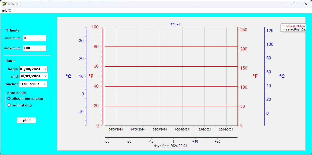

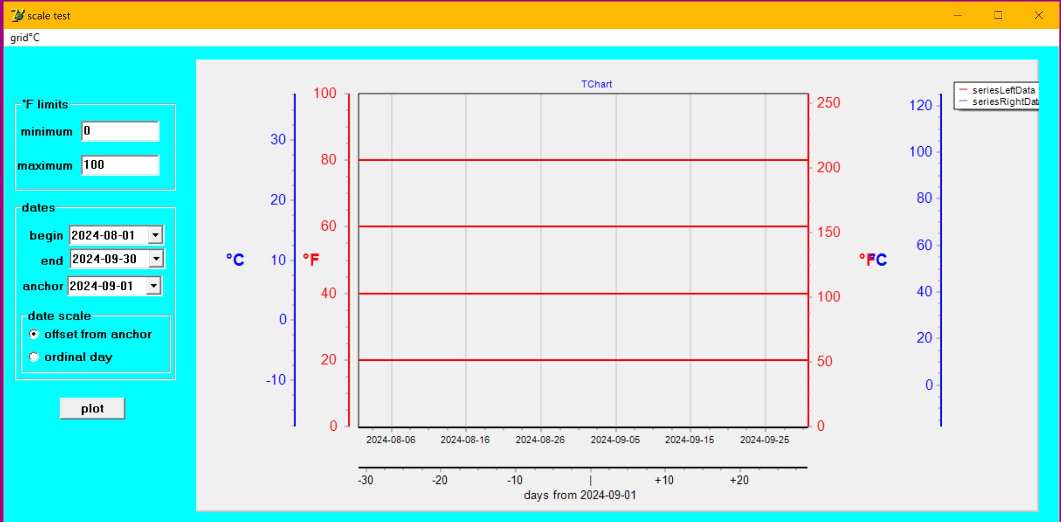

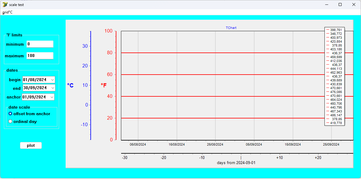

Here's yet another related issue. When I create a new axis to be an auxiliary scale on the right, it looks strange, because
  • As previously discussed, the title appears to the left of the scale, when it should be to the right. This will be fixable by using your new Distance parameter.
  • The ticks and labels are to the left of the axis, when they should be to the right. I don't think any existing user-accessible parameter controls this.
What might be good is to add a Side property to tChartAxis, with values [Left, Right, Top, Bottom]. Then when a user created a new axis with Side=Right, the axis's ticks & labels would automatically be on the right of the axis, and the default position of the axis title would be to the right of the labels. I wouldn't make such an axis have the PositionPercent behavior of RightAxis, but I suppose you might feel obligated to do that for a sort of consistency.

Here is another related issue. Your new Distance parameter will allow the title of right-sided auxiliary axes to be moved to the right of those axes, but the ticks and labels of those new axes will still come out on the left. As my latest demo (at https://www.fenichel.net/programs/ScaleTest.zip) shows, that doesn't look right.
What might be good is a new tChartAxis.Side parameter, with values {Left, Right, Top, Bottom}. Then a new axis with Side=Right could automatically get its title, ticks, and labels all to the right of the axis, with the title's horizontal position still tunable with Distance.

I believe I haven't correctly understood the initial issue.
This is what I see with your example:
So I don't see any axis at the right.
If you want an axis to be at the right side of the chart, you may want to set its OtherSide property to true. This way, the labels and title related to it will also change their side:

I think you are not looking at the latest version of my demo. When I run it I seeImage
But you're right; I hadn't noticed the OtherSide parameter. Should it be mentioned in the Axis chapter of the tutorial?

Post by Fenichel » Mon Sep 16, 2024 6:28 pm
The solution is even simpler than that. Once OtherSide is in play, no OthSide is needed. Since my tScale is a descendant of tChartAxis, I can just set
              OtherSide        := TheParentAxis.OtherSide;
around the same time as I set
              Horizontal       := TheParentAxis.Horizontal;
inside tScale's constructor.
My old ToggleGrid went through various hoops to move the RightAxis and any right-sided tScale around, but now it is straightforward. As you can see from the latest version of my demo (same location), all it needs now is Distance.

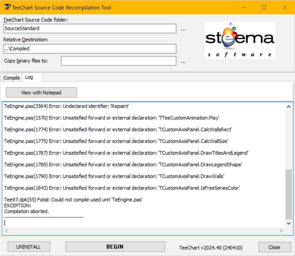

Here is a screenshot of errors from TeeRecompile:
TeeRecompile failure.jpg (199.43 KiB) Viewed 156226 times
Re: scales and axes
Post by Yeray » Fri Sep 20, 2024 7:09 am
According to the error message (Tee97.dpk), you seem to be compiling TeeChart Standard v2024.40 for Delphi 7.
I've just tried it here and worked fine:
Have you modified those sources to add the new Distance property? Make sure the changes are correct.

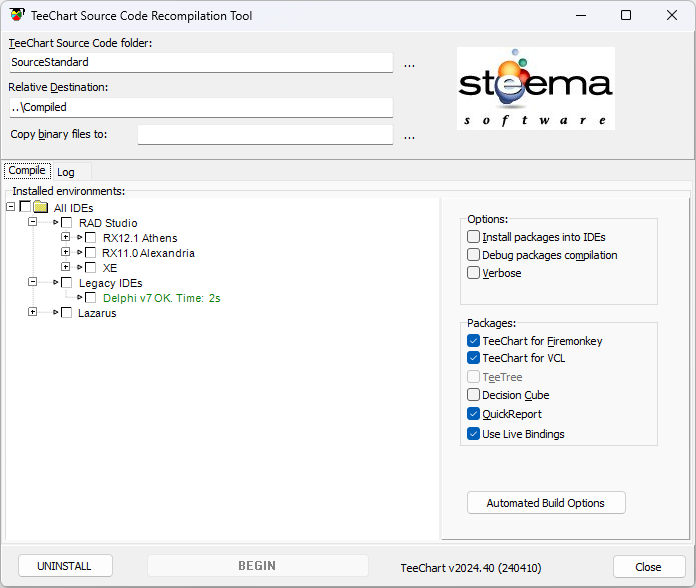

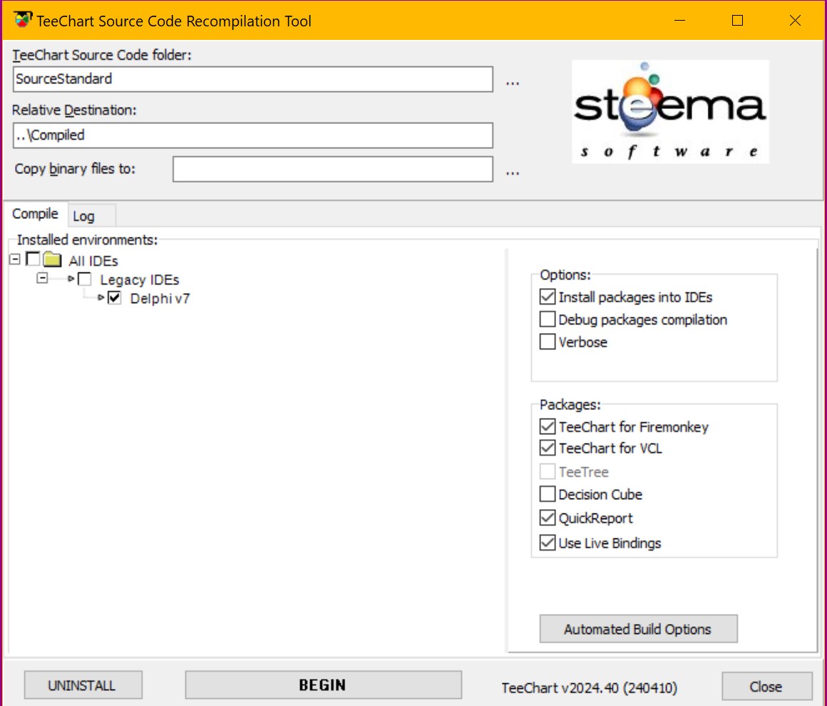

I can't tell what the problem is.
  • I can successfully run TeeRecompile with TeEngine.pas unmodified.
  • As carefully as I could, I re-edited TeEngine.pas to incorporate the changes you list in your post, and I get the same error messages.
  • That Repaint is undeclared is especially weird, since that is such a core Controls method.
  • Could I be checking the wrong boxes when I run TeeRecompile? Before I click Begin it looks likeImage
Could you put a copy of the correctly-edited TeEngine.pas somewhere for me to download?
Incidentally, in TChartAxis.CalcRect,
              if Horizontal then
                if OtherSide then
                   tmpDistance:=-FAxisTitle.Distance   // H+O+
                   tmpDistance:=FAxisTitle.Distance    // H+O-
                if OtherSide then
                   tmpDistance:=FAxisTitle.Distance   // H-O+
                   tmpDistance:=-FAxisTitle.Distance;  // H-O-
could be simplified to
if OtherSide = Horizontal then
  tmpDistance := -FAxisTitle.Distance
  tmpDistance := FAxisTitle.Distance
TeeRecompile config.jpg (127.99 KiB) Viewed 155916 times

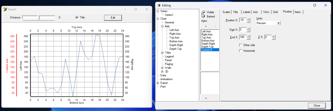

TeeRecompile now works for me. I must have been making some stupid transcription error in editing TeEngine.pas.
Distance works imperfectly for me.
  • It does fine with LeftAxis and RightAxis.
  • I haven't tried it on the top or bottom axes.
  • It seems to be ignored by auxiliary axes (my tScales).
As usual, my demo code is on my Web site at https://www.fenichel.net/programs/ScaleTest.zip.
Re: scales and axes
Post by Yeray » Mon Sep 23, 2024 9:23 am
Manually created axes do have their ResizeChart property set to false by default.
However, setting it to true will cause other side effects.
I'll investigate if there's anything else we can do.

After setting ResizeChart property to true for a custom axis, you can play with the Texts.MarginToAxis as well as the already mentioned Title.Distance and PostionPercent properties to adjust them as you wish:
