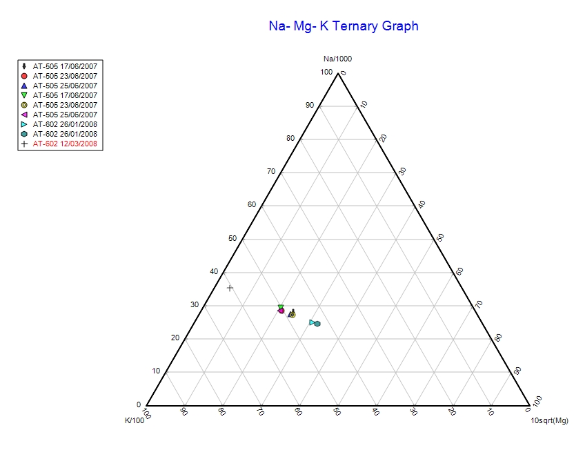

but I include a plot made with the latest code, that takes in two variables, x and y, to make the plot that I see similar to the example you posted in an earlier post. If this doesn't meet the requirement please let us know what changes are required, maybe even improvising points hand drawn on the image to reinforce the idea.Of course it would be necessary to draw the B-axis on the right, and overwrite the bottom axis with the reverse C axis

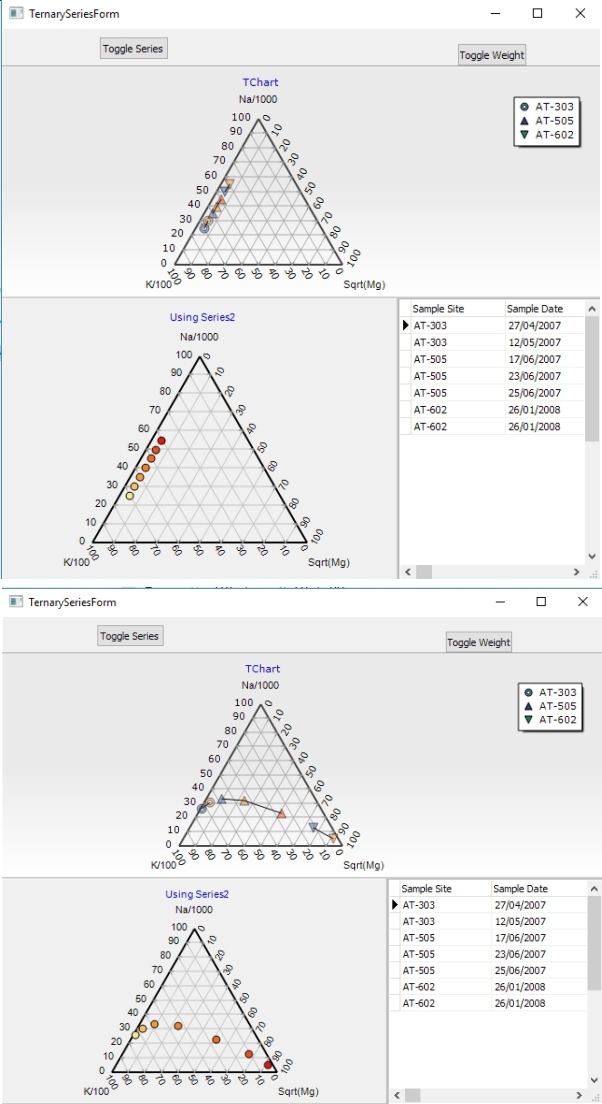

I wish to report an apparent error. I have attached a test program, importing data directly from a csv file and the same data via a kbmmemtable. I have used artificial data where the B value is 5% for all samples. The data also has a strongly varying Weight value. I have also attached two images to show how the data should be plotted and how it is actually plotted. Calculations show that the program is using the Weighting value instead of the YValue, for both the direct entry from the csv file and via a kbmmemtable.
I am also concerned that if no Weighting value is defined, the ternary chart is not drawn, without any warning or error. The weighting parameter is surely not that important - if not defined, it should be set to a constant value (0 or 1) for all data points.

- Top charts correct, bottom charts incorrect
- TernaryPlotResults.jpg (241.54 KiB) Viewed 24900 times

I have emailed you the earlier test project you uploaded, modified to use the new TeeChart units (also included) that now reproduce the charts you have requested.
Changes:
- Multiple Ternary Series supported without need for custom Axis code (http://bugs.teechart.net/show_bug.cgi?id=2231)
- two variable input supported (x,y) http://bugs.teechart.net/show_bug.cgi?id=2239
- No weighting needed when importing via SeriesTextSource (bugfix http://bugs.teechart.net/show_bug.cgi?id=2240)
*Note
A new property "DeriveZ := True;" is required if the data is being imported via datasets with only two of the three possible valuesets (ie x & y). When using add overloaded methods, setting the property is not required.
The last point is one I came across in earlier tests (see notes on mandatory-valuelist earlier in this thread) and answers your point:

I have downloaded and installed the modifications, which appear to have fixed the problem of the Weight parameter being incorrectly assigned. I can now generate a ternary plot but am having great difficulty with generating a customised legend. I have attached an XY plot showing the type of legend I would like to generate. This uses data from one or more columns in the dataset. I have also attached a test program that uses a kbmmemtable dataset that loads csv files. What I want to do is create a legend with one line corresponding to each series.
Any help you can give me would be greatly appreciated.
