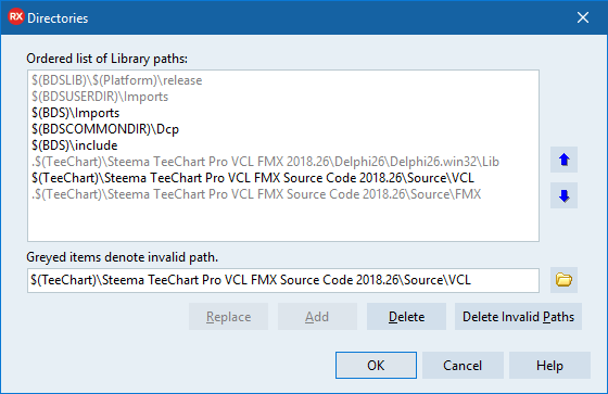

In the list of Library paths, make sure the "Sources\VCL" path is used and not the path to the binary install "Delphi26\Delphi26.*\Lib".
Ie, for win32, this is how I have it to use the binary installation: Note the lines starting with a "dot" aren't recognized and aren't used. I just have them to easily switch between versions.
Also note I use an "Environment Variable" named "TeeChart" $(TeeChart), which I use to point to where I have all the installations (I don't use the default "C:\Program Files (x86)\Steema Software").

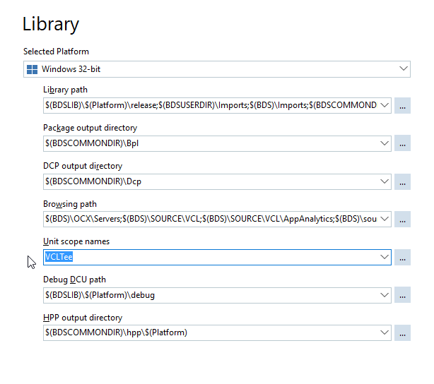

If I want to switch to use the VCL sources, I add a "dot" to comment the path I don't want to use and I remove the "dot" from the path I want to use: Also, make sure the "VCLTee" prefix is present in the "unit scope names" ("FMXTee" for FMX projects).

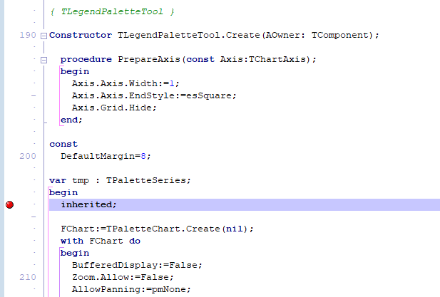

To test the TLegendPaletteTool I would add a breakpoint at it's Create function: When you run the test application, the IDE should stop there, and you can debug. F7 to "Trace into", F8 to "Step over", and F9 to continue running.

I made the change in the Library path but when I try to compile a simple project I get an error at line 98 of VCLTee.TeeProcs: [dcc32 Fatal Error] VCLTee.TeeProcs.pas(98): F2613 Unit 'TeCanvas' not found. I believe this is where I was stuck last time I tried to compile with sources but did not look into it any further, any thoughts of what could be wrong?

Let me insist on this and expand it with a screenshot:johnnix wrote: ↑Tue Dec 18, 2018 8:53 amI made the change in the Library path but when I try to compile a simple project I get an error at line 98 of VCLTee.TeeProcs: [dcc32 Fatal Error] VCLTee.TeeProcs.pas(98): F2613 Unit 'TeCanvas' not found. I believe this is where I was stuck last time I tried to compile with sources but did not look into it any further, any thoughts of what could be wrong?

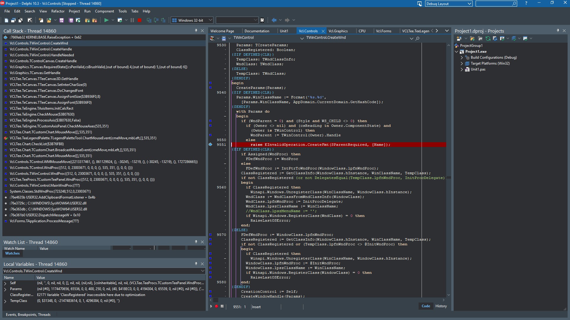

Ok, I now have the app compile fine with sources however the line that throws the exception is at VCL.Controls 9551 (procedure TWinControl.CreateWnd). I create the LegendPalette having a button on the form:
and once I move the mouse over the chart area I get the exception

When the exception occurs, you usually can see and navigate through the Call Stack (by default at the top-left corner) so you can see if there is some invalid parameter being passed to some function, or some array being accessed out of its bounds,...

Yes but unfortunately I do not know how to use this information

I see in your Call Stack the TTeeCanvas.DoChangedFont method is being called while in the example I run here it calls the TGDIPlusCanvas.DoChangedFont method.
So the difference seems to be in the Render option being used GDI vs GDIPlus.
If I change the Render in the "Options\New Chart" to "GDI" in the design time "Options" window, then I can reproduce the error.
So, could you please check if changing that option back to the default GDIPlus solves the problem for you?

I can verify that by setting the GDI+ option for new charts the error is gone, however I really need to work with GDI so if there is a quick fix for that please let me know
