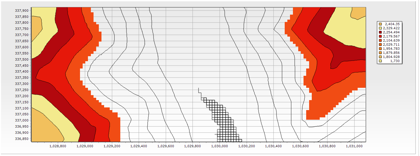

I am trying to contour elevations from a number of points.
For some reason the contour fill breaks up as shown in attached image.
If IrregularGrid := false then I get a blank grid.
Below is my code; I have excluded the query as it does not contribute.
I can provide the grid points by separate message as I can not post xlsx, csv or txt files.
  with Chart1 do
    View3D := False;
    RemoveAllSeries ;
    Title.Clear ;
  MyContour := TContourSeries.Create(chart1);
  Chart1.AddSeries(MyContour);
  with MyContour do
    IrregularGrid := true;
    Filled := chkFillLevels.checked;
    BeginUpdate ;
  with QInsSC do
	//Formulate Query that will pull values from DB and populate fields[0] - fields[2] with xx, yy, zz values
    Active := true;
    first;
    icount := 0;
    while not eof do
      inc(icount);
      xx   := fields[0].AsFloat;
      yy   := fields[1].AsFloat;
      if not fieldbyName('GPD_Z').IsNull then
        zz := fields[2].AsFloat;
        MyContour.AddXYZ (xx, zz, yy,  '', clTeeColor);
      next;

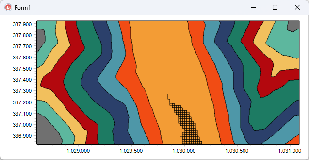

I've received the data in an .xlsx file. I transformed it to a .csv and loaded to a chart as follows:
uses Chart, TeEngine, TeeSurfa;
var Chart1: TChart;
var MyContour  : TContourSeries;
    tmpLines   : TStrings;
    tmpFields  : TStrings;
    n          : Integer;
    xx, yy, zz : Double;
const AFileName='D:\Downloads\Zach\250401_Contour\grid_for_steema.csv';
  Chart1:=TChart.Create(Self);
  with Chart1 do
    Parent:=Self;
    Align:=alClient;
    Color:=clWhite;
    Gradient.Visible:=False;
    Walls.Back.Color:=clWhite;
    Legend.Hide;
    View3D:=False;
  MyContour:=TContourSeries(Chart1.AddSeries(TContourSeries));
  with MyContour do
    IrregularGrid:=True;
    Filled:=True;
    BeginUpdate;
  tmpLines:=TStringList.Create;
  tmpLines.LoadFromFile(AFileName);
  n:=1;
  while n<tmpLines.Count do
    tmpFields:=TStringList.Create;
    tmpFields.Delimiter:=';';
    tmpFields.DelimitedText:=tmpLines[n];
    xx := StrToFloat(tmpFields[0]);
    yy := StrToFloat(tmpFields[1]);
    zz := StrToFloat(tmpFields[2]);
    MyContour.AddXYZ(xx, zz, yy);
    Inc(n);
  MyContour.EndUpdate;
And it looks correct for me here:
Could you please try the code above in a new simple project to see if it also works fine for you?
