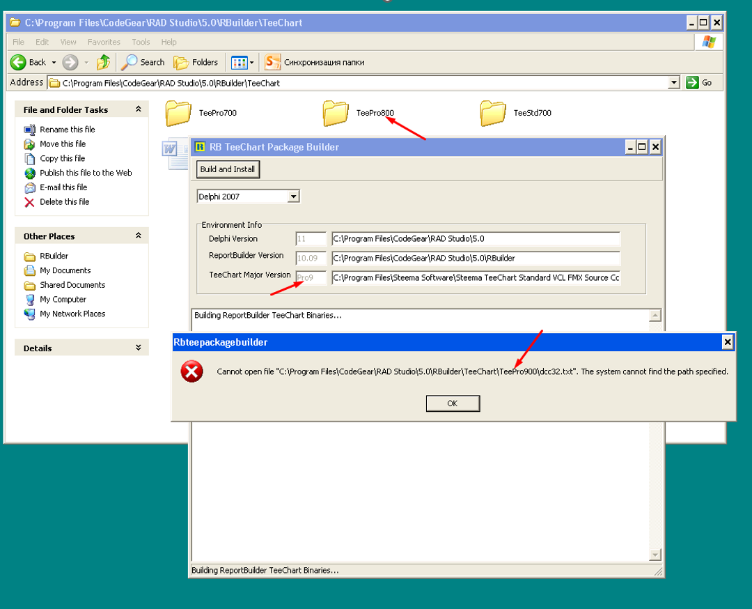

We are currently using ReportBuilder version 10.09 and TeeChart version 2016.17.160426 within our development environment (Delphi 2007). Unfortunately, we have encountered an issue where these versions appear to be incompatible. The specific error message we receive is as follows:
"Cannot open file 'C:\Program Files\CodeGear\RAD Studio\5.0\RBuilder\TeeChart\TeePro900\dcl32.txt'. The system cannot find the path specified."
This issue prevents us from successfully building the required binaries. Please see the attached screenshot for more details.
Could you kindly confirm which version of ReportBuilder would be compatible with TeeChart version 2016.17.160426? If additional steps or updates are required to resolve this compatibility issue, please let us know.
We appreciate your guidance and look forward to your response.

I'm afraid I don't know how to fix that error or what ReportBuilder is compatible with TeeChart v2016.17.
The integration of TeeChart into any other ReportBuilder is maintained and supported by Digital Metaphors.
They have a wiki that may help you here. Other than that, I'd suggest you to contact their team to get support on this.
