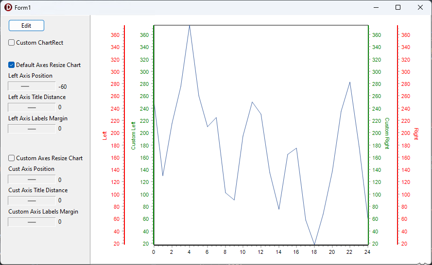

So, with these changes, you can set ResizeChart property to false and you'll see how Texts.MarginToAxis and Title.Distance properties modify Labels and Title positions without resizing the chart:
Note that, when ResizeChart property is set to true, Texts.MarginToAxis moves the Labels, and PositionPercent moves the Axis, but they don't resize the chart. I think we should improve that.

Those are good changes. Looking at the latest version of my demo (on my site in the usual place), everything works well. There is a mildly irritating left-right asymmetry of spacing (Is Distance always counting from the same side of the labels column, instead of an OtherSide-dependent side?), but it doesn't matter. I now realize that my graphs will want to fiddle with Distance in data-dependent ways, to keep the titles and labels of high precision from colliding.
