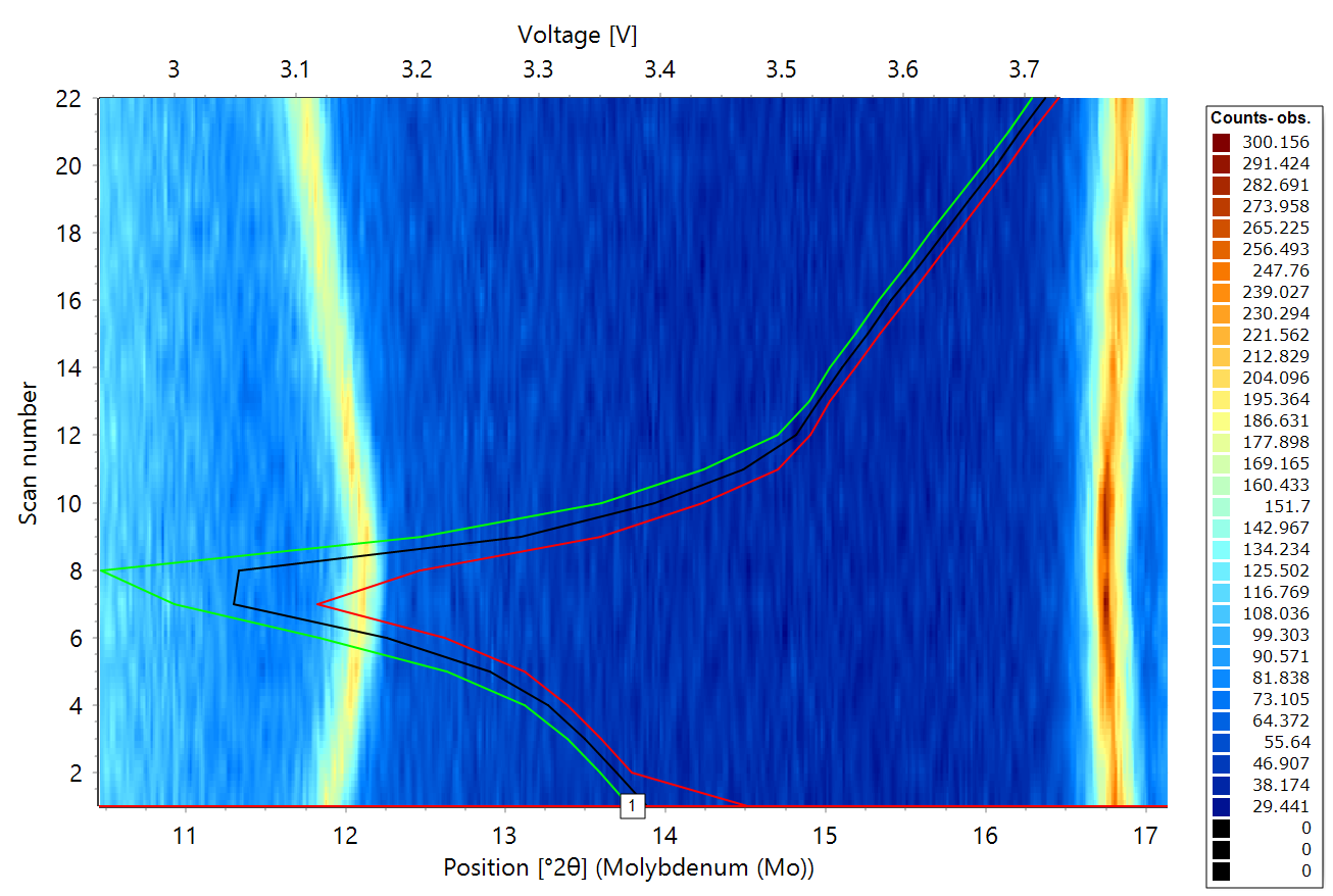

We produce graphics like in the attached plot with TChart, where we use a ColorGrid plus 3 Line Series.

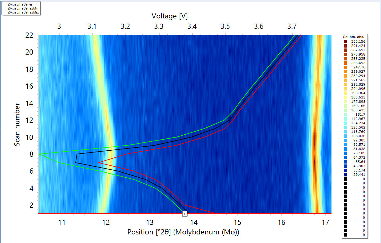

Usually we display the Colors of the Color Grid in the Legend. Now we want in addition to show a legend for the 3 Line Series. But when we include the Line Series in the Legend the Color Grid colors are vanishing, see attachment.
How can we have the Color Grid colors Legend AND a Legend for the Line Series?

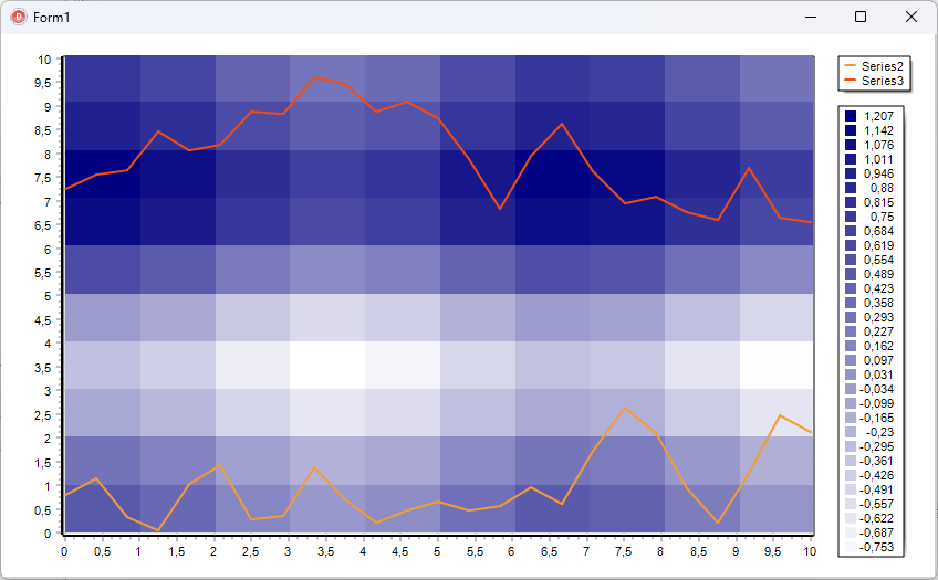

When the legend shows the palette, I don't see a lot of space to show any other item. Then, the ExtraLegendTool may be the most appropriate solution for this.
See the example here.

You could do something similar to the discussed here.
uses TeEngine, Chart, Series, TeeSurfa, TeeExtraLegendTool;
type TMyExtraLegendTool=class(TExtraLegendTool)
  protected
    procedure ChartEvent(AEvent: TChartToolEvent); override;
TLegendAccess=class(TChartLegend);
var Chart1: TChart;
procedure TMyExtraLegendTool.ChartEvent(AEvent: TChartToolEvent);
var i: Integer;
  if AEvent=cteAfterDraw then
    for i:=0 to ParentChart.SeriesCount-1 do
        ParentChart[i].ShowInLegend:=ParentChart[i] is TLineSeries;
    if Assigned(ParentChart) and Assigned(Series) then
      if Legend.Visible then
        TLegendAccess(Legend).CalcRect;
        Legend.DrawLegend;
procedure TForm1.Chart1BeforeDrawChart(Sender: TObject);
var i: Integer;
      Chart1[i].ShowInLegend:=Chart1[i] is TColorGridSeries;
var i: Integer;
  Chart1:=TChart.Create(Self);
  with Chart1 do
    Parent:=Self;
    Align:=alClient;
    Color:=clWhite;
    Gradient.Visible:=False;
    Walls.Back.Color:=clWhite;
    View3D:=False;
    OnBeforeDrawChart:=Chart1BeforeDrawChart;
  with TColorGridSeries(Chart1.AddSeries(TColorGridSeries)) do
    Pen.Hide;
    FillSampleValues;
  for i:=0 to 1 do
  with TLineSeries(Chart1.AddSeries(TLineSeries)) do
    Pen.Width:=2;
    FillSampleValues;
  Chart1.Draw;
  with TMyExtraLegendTool(Chart1.Tools.Add(TMyExtraLegendTool)) do
    Series:=Chart1[1];
    Legend.LegendStyle:=lsSeries;
    Legend.Left:=Chart1.Legend.Left;
    Legend.Top:=Chart1.ChartRect.Top;
