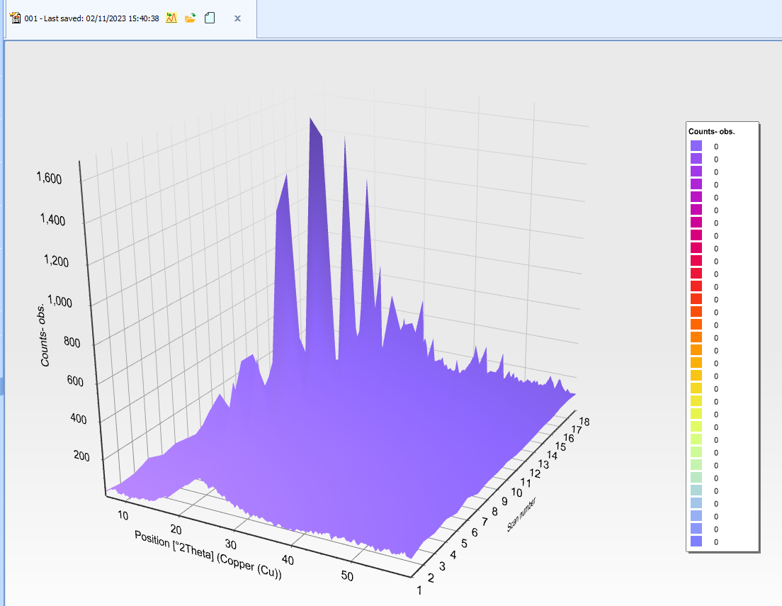

There is a problem/bug since the latest version of TChart VCL, with the Display of 3DGridSeries when "UsePalette" is set/used.
Everything is displayed in just ONE color and the Legend just shows Zeros.

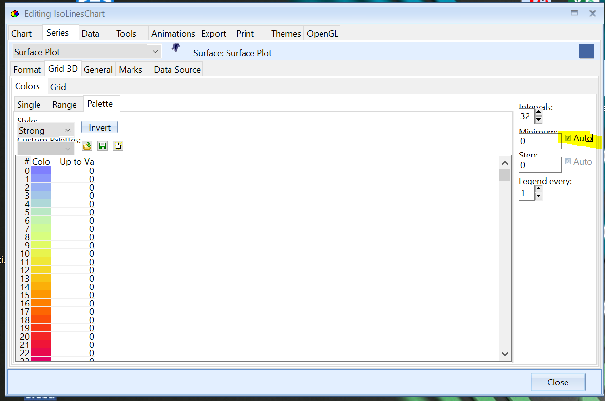

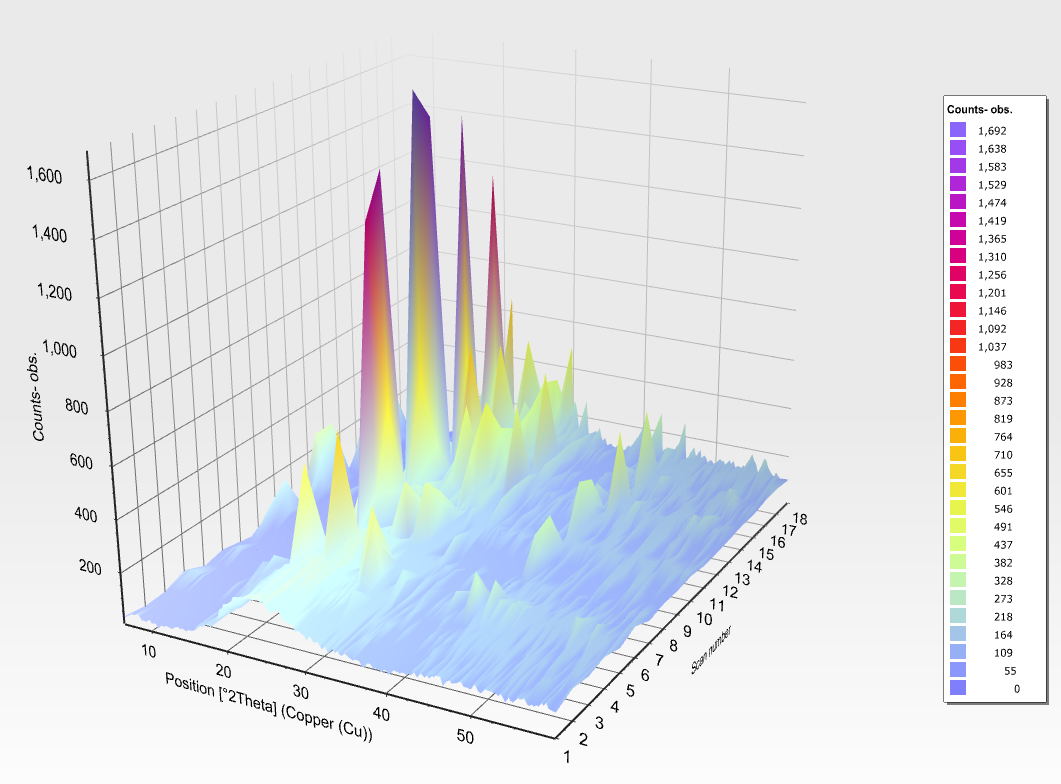

When I then go into the Chart dialog and Set "UsePaletteMin / Auto" to TRUE :
Its starts to get "normal":
Note that we do all Chart operation in code and when I set "UsePaletteMin" to True for the 3DGridSeries in Code, that
doesn't help, we still get the ONE Color Chart and zeros in the Legend. Only when I open the TChart Editor Dialog things get correctly updated. Is this bug known and fixed already?

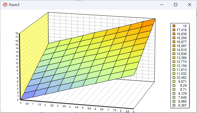

This simple example seems to correctly initialize the palette for me here:
uses Chart, TeeSurfa;
var Chart1: TChart;
var x, z: Integer;
  Chart1:=TChart.Create(Self);
  with Chart1 do
    Parent:=Self;
    Align:=alClient;
    Color:=clWhite;
    Gradient.Visible:=False;
    Walls.Back.Color:=clWhite;
    View3DOptions.Orthogonal:=False;
    Chart3DPercent:=100;
    Aspect.Zoom:=75;
    with TSurfaceSeries(AddSeries(TSurfaceSeries)) do
      UseColorRange:=False;
      UsePalette:=True;
      for x:=0 to 9 do
        for z:=0 to 9 do
          AddXYZ(x, x+z, z);
Do you see if I'm missing anything here?
