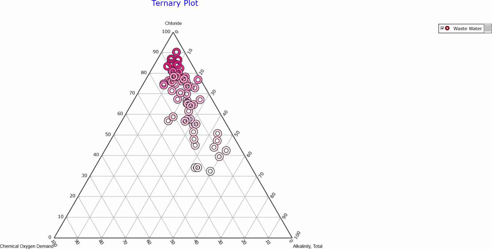

How do I automatically set a color gradient based on date. I want to be able to visually establish a how my data set may have changed through time, specifically in a triangular plot.

Could you please show us some image about what would you like to get?
DataInspector
Posts: 2
Joined: Mon Aug 08, 2022 12:00 am
Re: Set color gradient based on time series
Post by DataInspector » Tue Jun 13, 2023 9:37 pm
Attached is a concept
Here is the code I am currently using
Trilinear Plot.jpg (53.29 KiB) Viewed 18406 times

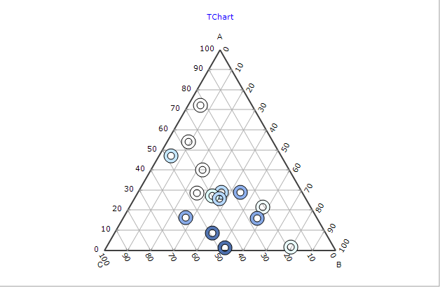

I would use a TTernarySeries and use ApplyBright function to define the color of each point from the series base color and calculating the HowMuch argument (0-255) depending on the date, probably coming from the database.
uses TeeTernary, TeCanvas;
var i: Integer;
  Chart1.Align:=alClient;
  Chart1.View3D:=False;
  Chart1.Color:=clWhite;
  Chart1.Legend.Hide;
  with TTernarySeries(Chart1.AddSeries(TTernarySeries)) do
    Pointer.Style:=psDonut;
    Pointer.Size:=10;
    UseColorRange:=False;
    UsePalette:=False;
    ColorEachPoint:=False;
    FillSampleValues;
    for i:=0 to Count-1 do
      ValueColor[i]:=ApplyBright(Color, Round(random*255));  // change the second argument for a value date - dependant

Thanks for the advice. I couldn't find a lot of information for ApplyBright and have a question.
What are the range of integers allowed?
Post by Yeray » Wed Jun 14, 2023 7:16 pm
It allows 0 to 255.
