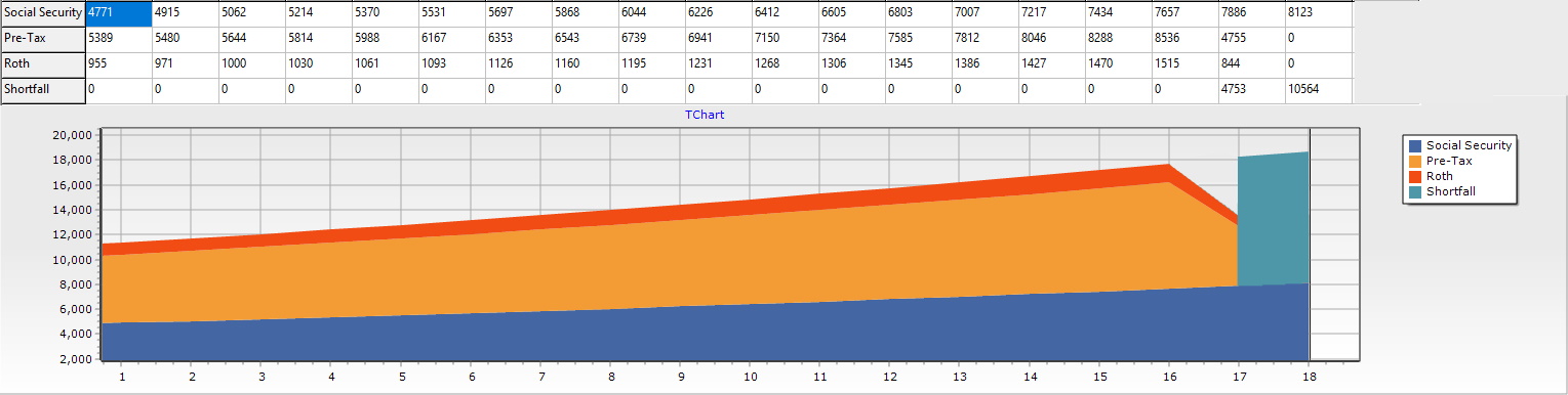

Post by Test Always #? » Thu Mar 23, 2023 5:09 pm
Thank you for your response.
Here is a link to an image that I have working (sorry, I could not get the "img" tags to work and display the image in the preview):
http://www.tbinc.com/misc/A.jpg
When the cash flows get more complex, it falls apart--e.g., incomes starting and stopping. It took me a lot of work to get this one working.
I need them to step down, not slide down.
Does that make sense?
Ed Dressel

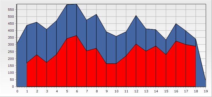

Post by Marc » Tue Apr 18, 2023 4:33 pm
We see a obstacle to us adding the step-up/down as a generic feature because for stacked charts, if another series in the stack has values and another doesn't, a stack could show up as hollow
ie.
which is, data-wise, true to the values of the blue series, but aesthetically not particularly attractive,
or .... to fill-down the blue.
ie.
which is aesthetically easier on the eye, but data-wise gives the impression that, for example, the penultimate blue value is very large, which it isn't.
We are up for thinking this through further and working with any feedback, but at the moment we feel that a generic implementation wouldn't be true to the data in many cases.

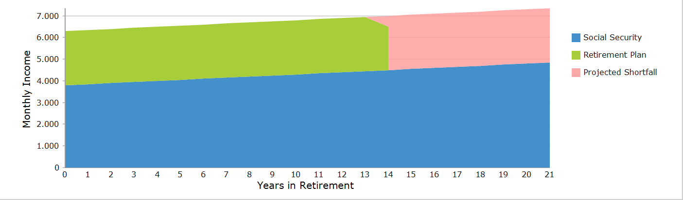

Post by Yeray » Wed Apr 26, 2023 6:23 am
I made a simple example trying to replicate the image you posted above.
Here the result:
And the code to make it:
uses Series;
var i, tmp: Integer;
  Chart1.View3D:=False;
  Chart1.Hover.Hide;
  Chart1.Walls.Back.Hide;
  Chart1.Color:=clWhite;
  Chart1.Axes.Bottom.Grid.Hide;
  Chart1.Legend.Pen.Hide;
  Chart1.Legend.Shadow.Hide;
  Chart1.Legend.VertSpacing:=15;
  Chart1.Title.Hide;
  Chart1.Axes.Left.Title.Text:='Monthly Income';
  Chart1.Axes.Bottom.Title.Text:='Years in Retirement';
  Chart1.Legend.Font.Size:=12;
  Chart1.Axes.Left.Title.Font.Size:=15;
  Chart1.Axes.Bottom.Title.Font.Size:=15;
  Chart1.Axes.Left.LabelsFont.Size:=12;
  Chart1.Axes.Bottom.LabelsFont.Size:=12;
  Chart1.Axes.Left.Axis.Width:=1;
  Chart1.Axes.Left.MinorTicks.Hide;
  Chart1.Axes.Bottom.Axis.Width:=1;
  Chart1.Axes.Bottom.Ticks.Hide;
  Chart1.Axes.Bottom.MinorTicks.Hide;
  with TAreaSeries(Chart1.AddSeries(TAreaSeries)) do
    Color:=$CA9044;
    Title:='Social Security';
    Pen.Hide;
    AreaLinesPen.Hide;
    MultiArea:=maStacked;
    tmp:=3800;
    for i:=0 to 21 do
      if (i=14) then
         AddXY(i, tmp);
      AddXY(i, tmp);
      Inc(tmp, 50);
    Color:=$3ACDA7;
    Title:='Retirement Plan';
    Pen.Hide;
    AreaLinesPen.Hide;
    tmp:=2500;
    for i:=0 to 21 do
      if (i=14) then
        AddXY(i, 2000);
        tmp:=0;
      AddXY(i, tmp);
    Color:=$9998FF;
    Title:='Projected Shortfall';
    Transparency:=20;
    Pen.Hide;
    AreaLinesPen.Hide;
    tmp:=0;
    for i:=0 to 21 do
      if (i=14) then
        AddXY(i, 500);
        tmp:=2500;
      AddXY(i, tmp);
I haven't tried that data with the code in your "method 2", but the idea is very similar. Doesn't it work for you?
