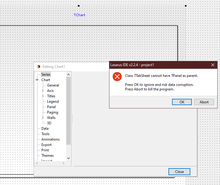

I can install it manually in the IDE but upon use I get this error when trying to use the TeeChart Editing dialog box...
Screenshot 2022-12-15 095624.png (22.56 KiB) Viewed 17717 times

Post by Yeray » Fri Dec 16, 2022 7:46 am

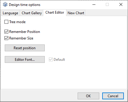

I see the error in "Tree mode". We'll investigate what's wrong.
Meanwhile, please open the "options" and uncheck it.

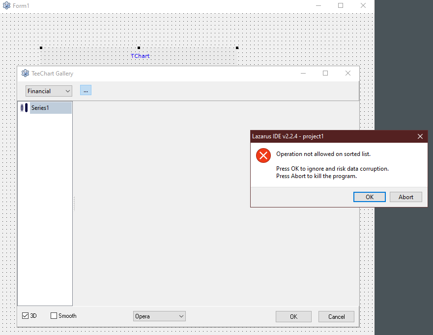

When doing so I can get a little further but upon choosing an item from the gallery it stops with...
Screenshot 2022-12-16 094742.png (91.47 KiB) Viewed 17665 times

Re: Recompilation tool issue
Post by Yeray » Mon Dec 19, 2022 7:33 am
At TeeGally.pas, find the TTeeGallery.SwitchAlternate procedure and modify this line:
      ChartListBox1.Sorted:=True;
For this:
      {$IFNDEF LCL}
      {$ENDIF}
And rebuild the package.
I'm sorry for the inconveniences.
Post by Yeray » Mon Dec 19, 2022 10:59 am
Hello again,
The above could be considered as a fast workaround.
I've just implemented the definitive fix (I hope so) for #2578.
The fix consists on adding a couple of lines of code at TTeeGallery.CreateChartList, in TeeGally.pas unit, setting Sorted:=False befode updating the ChartListBox1 and restoring it at the end:
Procedure TTeeGallery.CreateChartList(Const APage:String);
  ChartListBox1.Items.BeginUpdate;
  ChartListBox1.Sorted:=False;
  try
  finally
    ChartListBox1.Sorted:=AlternateStyle;
    ChartListBox1.Items.EndUpdate;

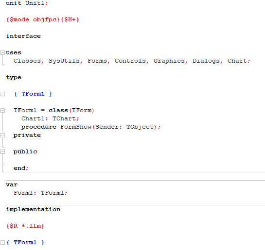

That got rid of the sort error, but things are odd.
If you choose something from the series gallery the associated code is not generated and if you do too much in the gallery it crashes.
Here are some screenshots...
Screenshot 2022-12-19 231759.png (30.32 KiB) Viewed 17439 times
The resultant code:
Screenshot 2022-12-19 231827.png (14.85 KiB) Viewed 17439 times

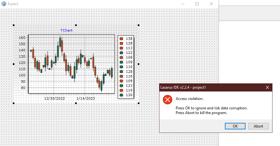

After making changes to a series from the gallery, like checking "smooth" etc.:
Screenshot 2022-12-19 230806.png (30.75 KiB) Viewed 17439 times

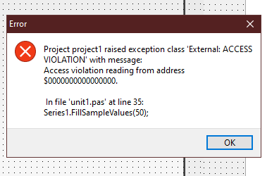

Also, I have tried to use without the Gallery with this test...
pssdw
uses
  Classes, SysUtils, Forms, Controls, ExtCtrls, Graphics, Dialogs, StdCtrls,
  TeEngine, Chart, TeeGDIPlus, Series, TeeProcs;
type
  { TForm1 }
  TForm1 = class(TForm)
    Chart1: TChart;
    Series1: TLineSeries;
    procedure FormShow(Sender: TObject);
  private
  public
var
  Form1: TForm1;
implementation
{$R *.lfm}
{ TForm1 }
procedure TForm1.FormShow(Sender: TObject);
  Series1.FillSampleValues(50);
Screenshot 2023-01-02 155516.png (8.42 KiB) Viewed 17260 times
