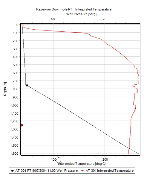

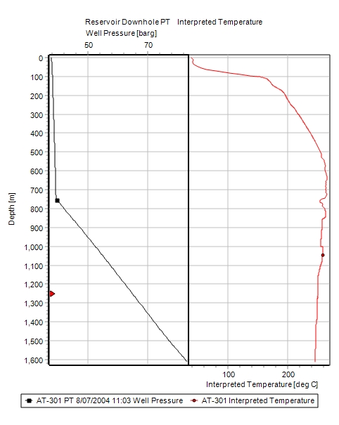

I use TeeChart to plot two data sets on a common axis - see Two_Graphs.jpg. The second graph uses custom axes.

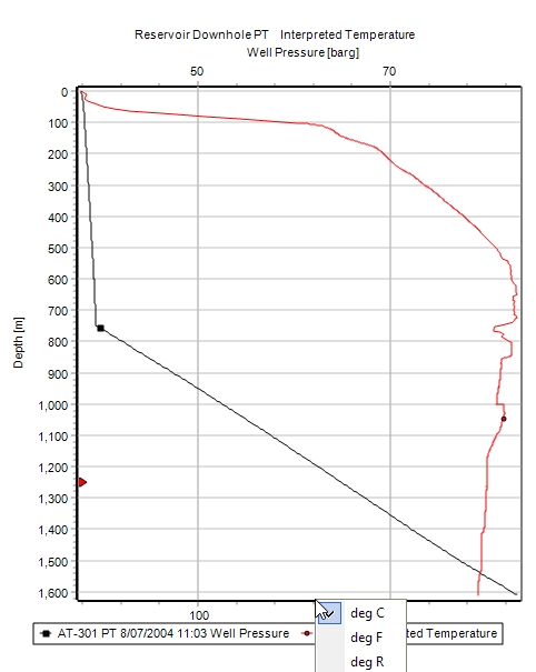

When the top axis is used in one graph and the bottom axis in the other, I can merge the two graphs into a single graph. If I set the bottom axis LabelStyle to talNone, the legend is placed correctly, but the units popup does not work on the bottom axis - see Single_Graph_Correct_Legend_no_popup.jpg. If I set BottomAxis.Visible to false, the units popup is activated but the legend is misplaced - see Single_Graph_Legend_Misplaced.jpg.

I am sorry my explanation was not clear. In the merged chart, there are two overlaid axes, BottomAxis and CustomAxes[5].
In both cases, BottomAxis.LabelStyle is set to talNone.
If BottomAxis.Visible is True, the chart Legend is correctly placed below the BottomAxis title, but the units popup acts on BottomAxis and does not fire because there is no data associated with BottomAxis.
If BottomAxis.Visible is False, the units popup acts on CustomAxes[5] and fires correctly.. However, in this case. the chart Legend is not placed correctly, and obscures the BottomAxis title.
As far as I can see, I need show the BottomAxis to get the legend to be placed correctly. Is it possible to either place CustomAxes[5] on top of BottomAxis so the Units Popup is triggered by CustomAxes[5], or to associate the chart Legend with CustomAxes[5]?
