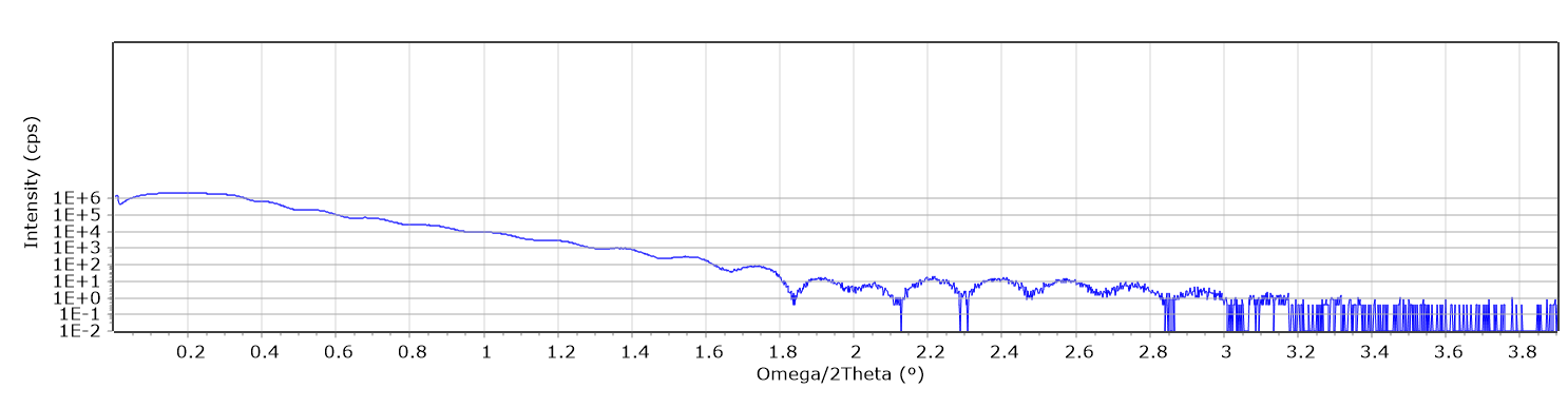

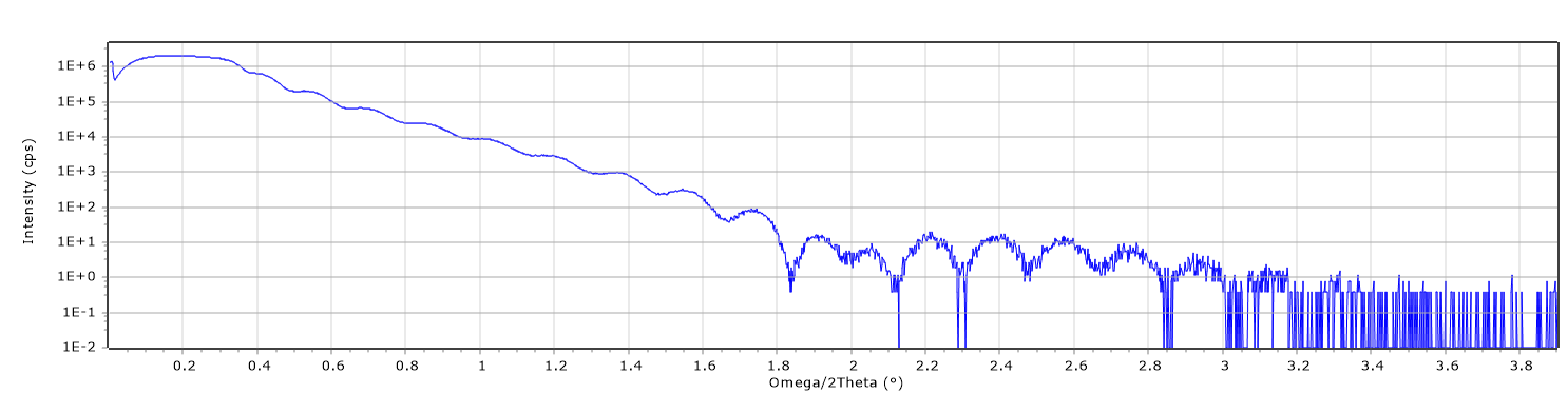

I have seen this as well, logarithmic scaling has changed from 2022.35 to 2022.36. See the attached images.
Version 2022.36
Plot 2022_36.png (36.75 KiB) Viewed 15705 times
Version 2022.35
Plot 2022_35.png (44.79 KiB) Viewed 15705 times
