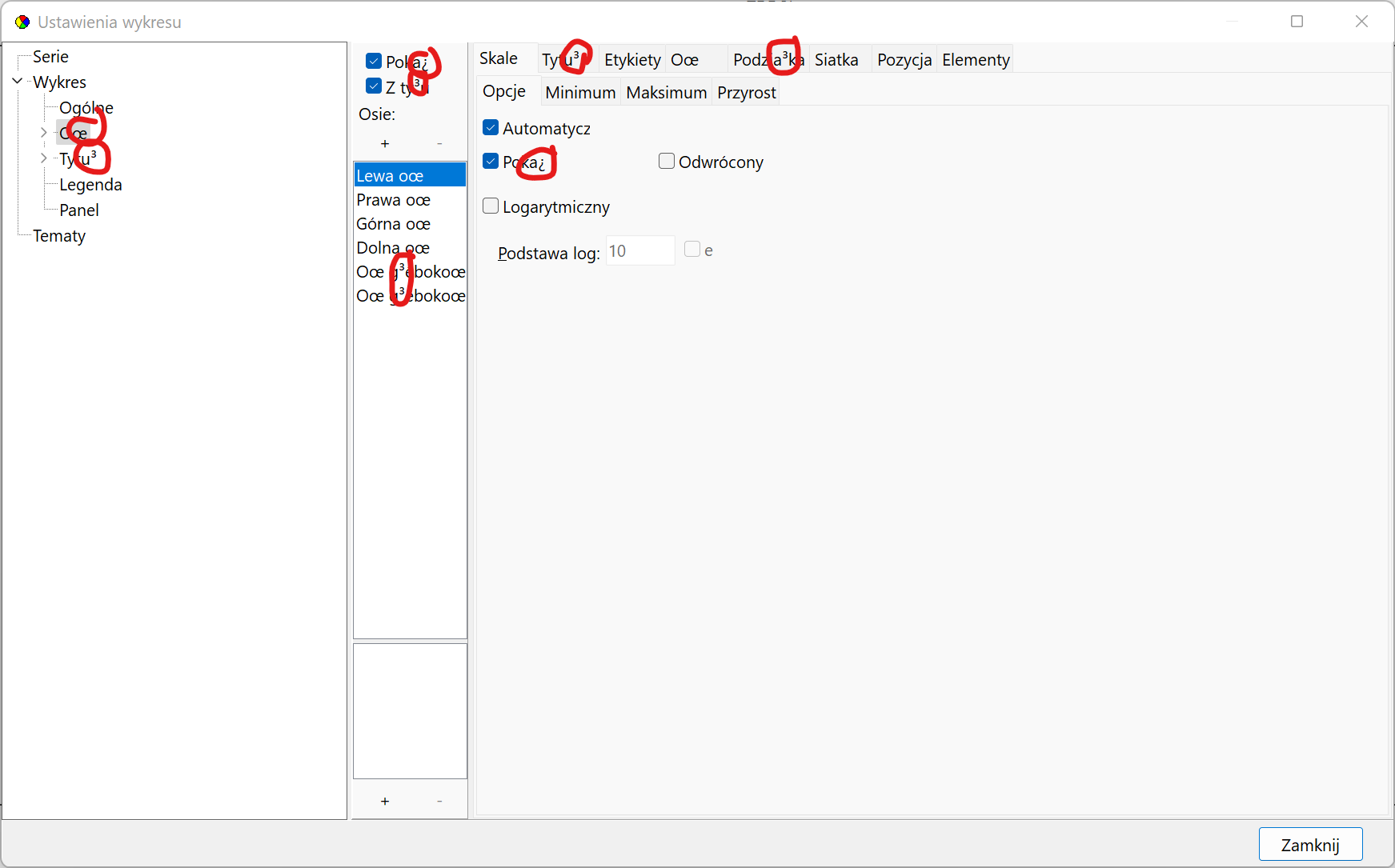

3. After installation but before compilation VCL there are 2 language files - in my example for Polish: TeePolish.pas and VCLTee.TeePolish.pas (maybe also FMX one). First is ANSI encoding, second one UTF-16LE. The UTF-16LE version is broken about translations. It produce this:
bad encoding.png (66.62 KiB) Viewed 13309 times

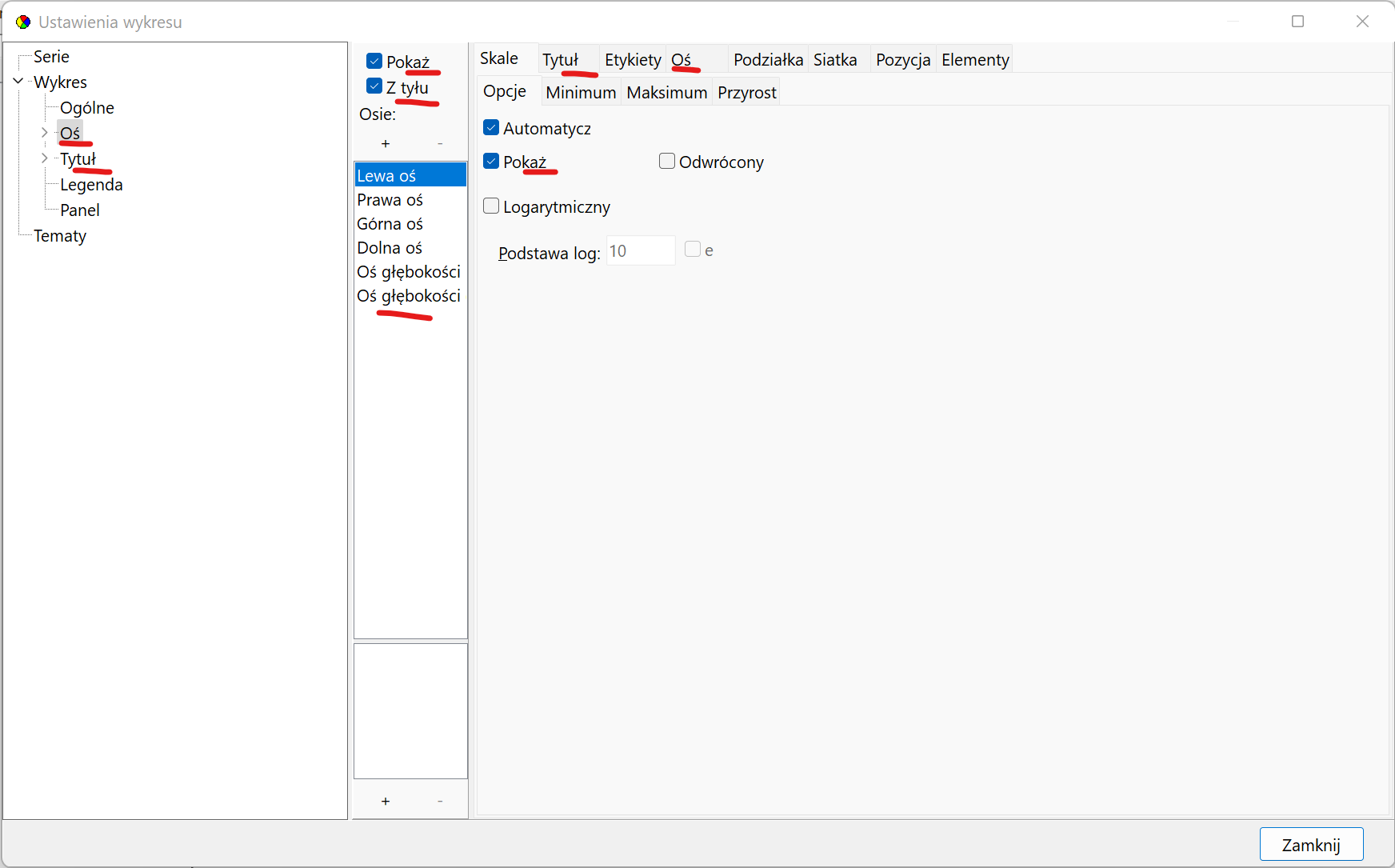

After every update i have to copy content from TeePolish (ANSI) to VCLTee.TeePolish (UTF-16LE) and change conding of file to ANSI or convert external for UTF-16LE. After this i get proper text:
Can it be repair? I've searched forum but i don't find that anyone else had this problem.

Some of the files are encoded in ANSI and some in UTF-16 LE BOM. File VCLTee.TeePolish.pas located in "..\Source\VCL\" have good translation (encoded in UTF-16 LE BOM). I've opened that file in Notepad++ and copy/paste it's content to the VCLTee.TeePolish.pas located in "..\Source\UnicodeLangs\VCL\" (also encoded in UTF-16 LE BOM but with errors in encoding). After recompile TeeChart i got proper translation in VCL in Delphi. I think the same should be done for FMX.

In 2022.36.220929 translations are good. The problem doesn't exists.
