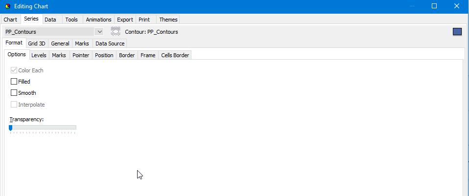

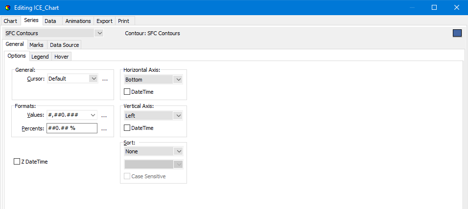

I have 2 applications which contain contour series built in code as follows:
  var aContourSeries := Chart.AddSeries(tContourSeries) as tContourSeries;
In one application the chart editor "Series" tab has 5 sub-tabs including "Format" and "Grid 3D" in the other application these tabs are missing. Without the Format tab, the user can't reset the contour levels. Any Idea why? The code in both applications looks very similar. See the screenshots below - I note that the version with the extra tabs has a "contour Icon" next to the series name and the other doesn't.

Some tabs are split in different units. You can add the TeeContourEdit to add the "levels" tab.
However, note the editor is designed to help the developers to build and test their applications, not to be accessed by the final users, so we don't recommend giving access to it.

Thanks. Adding TeeContourEdit to the form unit hosting the editor worked fine. I have no idea why the other app showed the contour level tab as that form also did not use TeeContourEdit.
