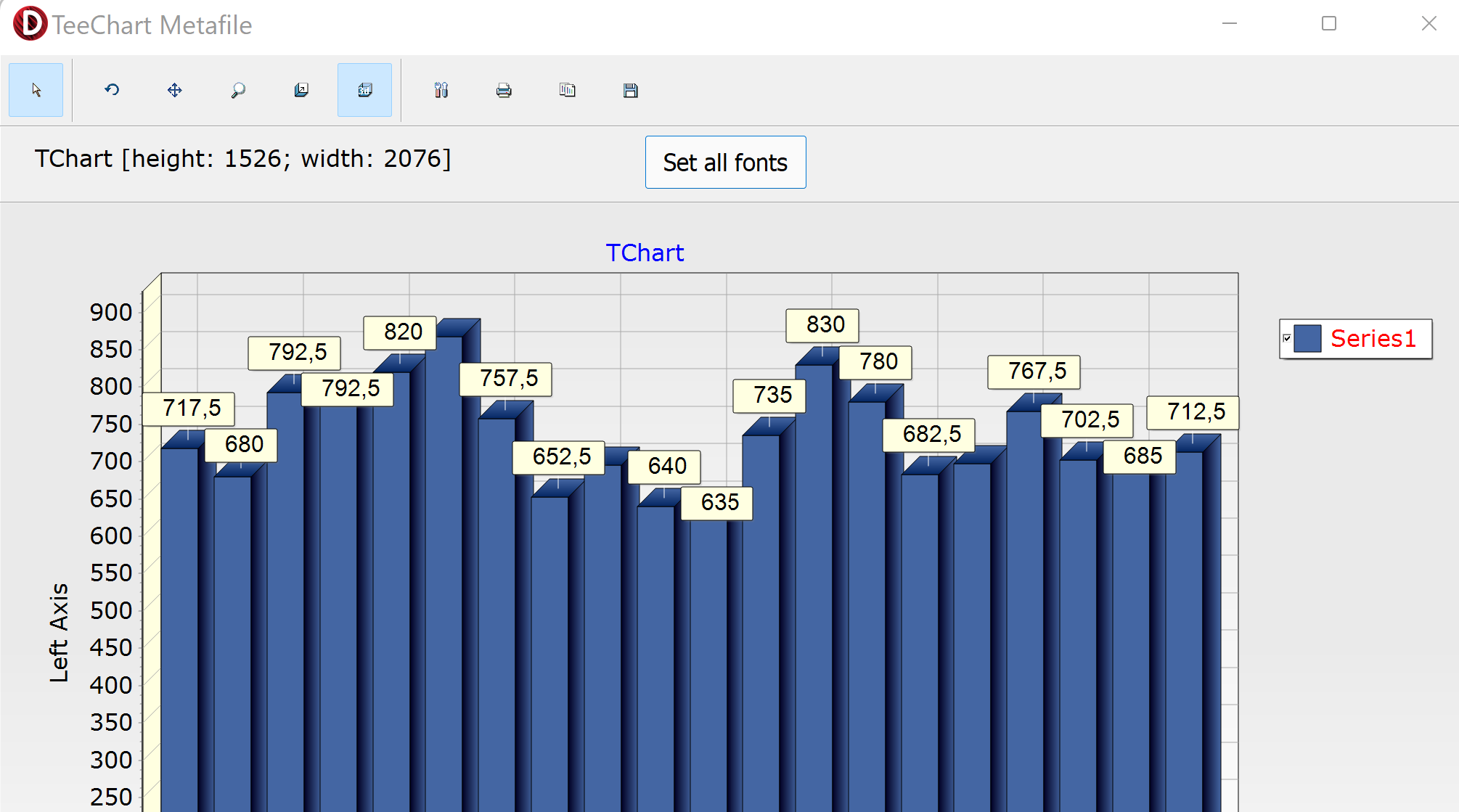

Here is the DisplaySize example with a checkbox in the legend. The snapshot is taken from a 300% scaling on a high DPI monitor.
As you can see the checkbox is far from usable. Also the icons in the bar get unreadable. The images do not properly scale.
In a setup with 2 screens with different resolutions the program should be aware about the change of scaling and/or resolution (shift of GUI between monitors). Therefore the program or here better chart must get information about a change.

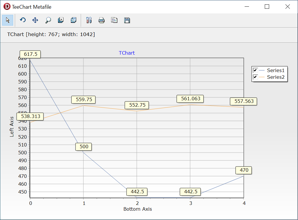

A simple line series with pen width = 1 gets very thin on a high DPI monitor. So actually I try to help myself by Pen.Width := nominal_pen_width * Screen.PixelsPerInch / 96 as a quick turnaround.
It doesn't look bad for me at 150%:
But you could try to override the ChangeScale method and change the series pen width there.
