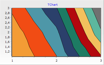

A and C look the same. Are you sure this is correct?
A contour with A, B and D looks like this:
  Series1.AddXYZ(1, 5, 1);
  Series1.AddXYZ(2, 10, 1);
  Series1.AddXYZ(3, 20, 1);
  Series1.AddXYZ(1, 6, 2);
  Series1.AddXYZ(2, 12, 2);
  Series1.AddXYZ(3, 25, 2);
  Series1.AddXYZ(1, 8, 3);
  Series1.AddXYZ(2, 15, 3);
  Series1.AddXYZ(3, 28, 3);
Deppending on the data, you may need to add this (but with the data above it isn't necessary):
  Series1.IrregularGrid:=True;

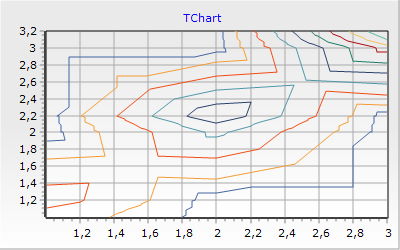

Post by Yeray » Thu Dec 23, 2021 3:28 pm
We've been playing with your data and got to the idea of filling the gaps with 0s (or -1s).
Then, we'd modify the first UpToValue in Levels so the gaps aren't drawn:
  Series1.Filled:=False;
  Series1.AddXYZ(1, 5, 1.0);
  Series1.AddXYZ(2, 0, 1.0);
  Series1.AddXYZ(3, 0, 1.0);
  Series1.AddXYZ(1, 0, 2.0);
  Series1.AddXYZ(2, 10, 2.0);
  Series1.AddXYZ(3, 0, 2.0);
  Series1.AddXYZ(1, 0, 3.0);
  Series1.AddXYZ(2, 0, 3.0);
  Series1.AddXYZ(3, 20, 3.0);
  Series1.AddXYZ(1, 6, 1.1);
  Series1.AddXYZ(2, 0, 1.1);
  Series1.AddXYZ(3, 0, 1.1);
  Series1.AddXYZ(1, 0, 2.1);
  Series1.AddXYZ(2, 12, 2.1);
  Series1.AddXYZ(3, 0, 2.1);
  Series1.AddXYZ(1, 0, 3.1);
  Series1.AddXYZ(2, 0, 3.1);
  Series1.AddXYZ(3, 25, 3.1);
  Series1.AddXYZ(1, 8, 1.2);
  Series1.AddXYZ(2, 0, 1.2);
  Series1.AddXYZ(3, 0, 1.2);
  Series1.AddXYZ(1, 0, 2.2);
  Series1.AddXYZ(2, 15, 2.2);
  Series1.AddXYZ(3, 0, 2.2);
  Series1.AddXYZ(1, 0, 3.2);
  Series1.AddXYZ(2, 0, 3.2);
  Series1.AddXYZ(3, 28, 3.2);
  Series1.CreateAutoLevels;
  Series1.Levels[0].UpToValue:=1;
