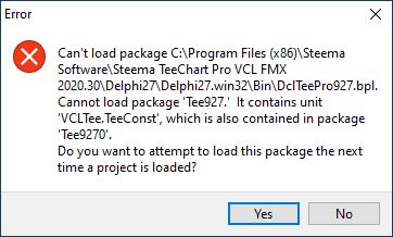

I have installed version 2020.30 of the teechart pro over the 2 versions of delphi that I have.
Version 10.2 worked without any problem in version 10.4, it gives me this error when opening.
Delphi 10.4 Install Error

The error message "Cannot load package *Tee*. It contains unit *, which is also contained in package *Tee*", where any of the *Tee* packages ends with a "0" (*Tee*0), indicates that the TeeChart Standard package that was shipped with the IDE (*Tee*0) is still trying to be loaded, and this creates a conflict with the version you've just installed.
There are two possible causes and solutions for this error:
- If the TeeChart Standard/Lite package shipped with the IDE (*Tee*0) is present and selected in the list of packages in the IDE, please uncheck it. Then you should be able to select the TeeChart Pro/Std commercial package (*Tee*) in the same list.
- There are some 3rd party tools (*) that can be referencing the TeeChart Standard/Lite package shipped with the IDE, and thus causing this conflict. Please try to uncheck temporally any 3rd party tool package you may have installed in the list of packages to try to identify which one is causing the conflict.

Installing & uninstalling & reinstalling several times probably leaves some undesired entries in the paths on your IDE. It's always a good idea to clean the paths following the instructions here.
However, if you are getting an error about a conflict with a Tee package ending with zero (*Tee*0), then follow the instructions on the post above since you seem to have packages loading different versions of TeeChart and you need to unify all them.
