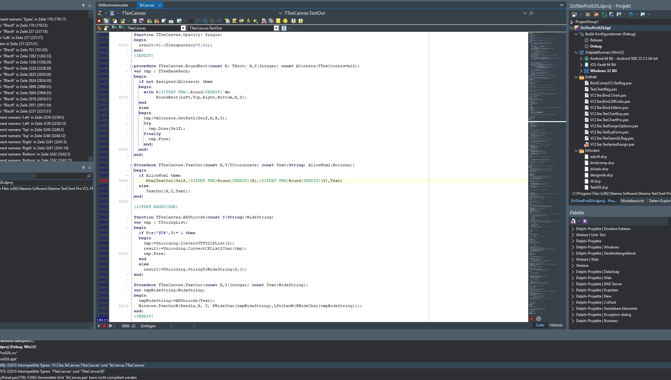

TeePro926.dproj is compiling without any problems. But we get in DclTeePro926.* a complier error (E2010).
We have checked the path in Delphi and in the project and we used "VCLTee"
With DclTeePro926.dpk (or DclTeePro926.dproj) t seems it's like the error in:
viewtopic.php?p=67773#p67773
We have tried to change back to 2020.29, the error still exists.
We had attached a screenshot

The file open (TeCanvas.pas) is located at the "Source" folder by default. If the compiler is finding it, it must be that this path is somewhere in your library or search path. Please search for it and remove it or change it for "Source/VCL" depending on your needs.
