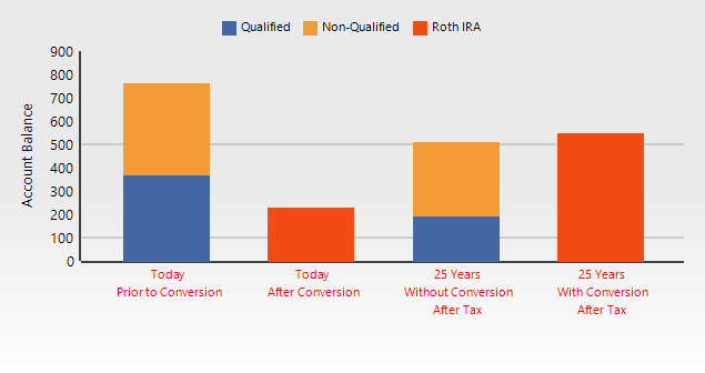

Indeed setting thinner bars seems to help:
  for i:=0 to chrRothConvert.SeriesCount-1 do
    TBarSeries(chrRothConvert[i]).BarWidthPercent:=50;

In your dfm I see you've set the bottom axis MinimumOffset and MaximumOffset to 48. Removing that reduces that space and you don't even need to set the BarWidthPercent to 50 to see all the labels:
