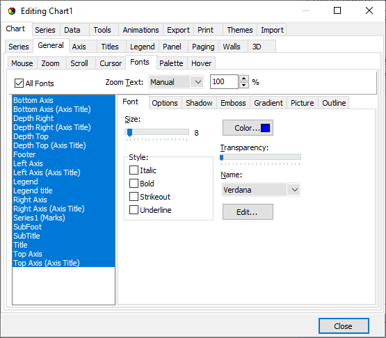

You can navigate to the "Chart\General\Fonts" tab in the editor, select "All Fonts" and change the settings:

That is sweet! Way to make my Friday!
