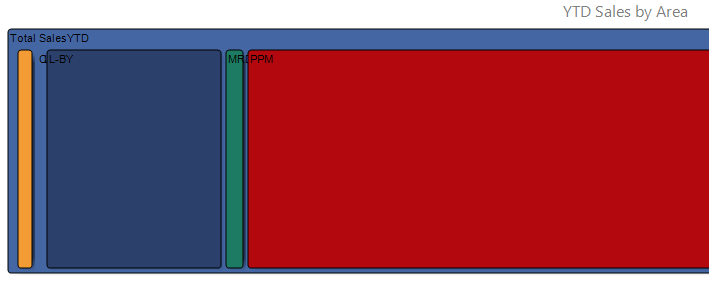

What properties of the TTreeMap series do I need to set to remove the borders around each box, including the outer box "A"?
I have tried
Series.Pen.Color := clWhite
Perhaps what I am seeing is a shadow? In that case, how to remove the shadow?
Also, what properties do I need to set to remove the space around each box? I'd like to show the boxes abutting each other.
I can't even see how to do these things using the Chart Editor GUI.
Regards
Mark

You should modify each Item Format. Ie:
var i: Integer;
  for i := 0 to Series1.Count-1 do
    with Series1.Item[i].Format do
      Pen.Visible:=False;
      Shadow.Visible:=False;

Works like a charm!
Thanks so much :)
